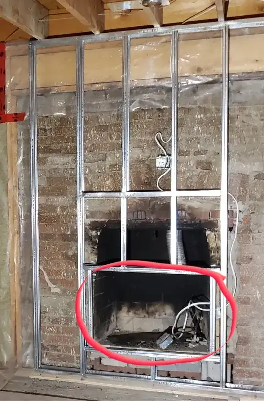

    Is that... a device box inside your cupboards? Because that's *definitely* illegal. As is NMD cable running outside a wall without protection. – J... Apr 06 '22 at 11:59

    While we're looking at code violations: The box has a conduit clamp on cable. It should have a cable clamp and the other conduit clamp should be removed and a blanking plate installed. – FreeMan Apr 06 '22 at 14:06

    The box even has a ground screw conveniently installed in the proper spot in the back – FreeMan Apr 06 '22 at 14:06
