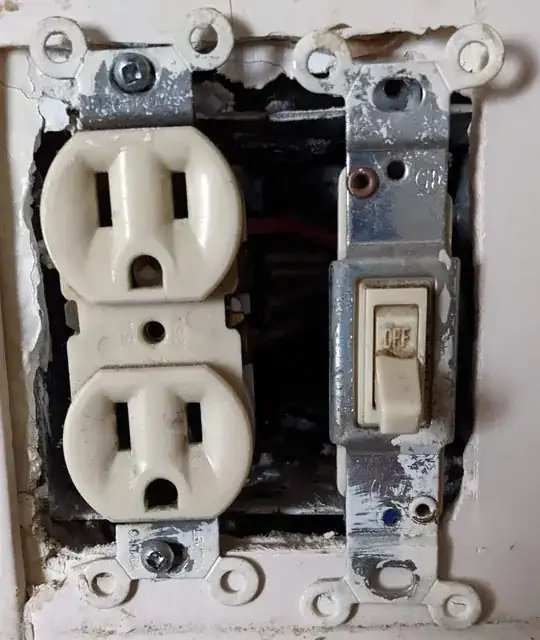

The switch on the right of the combo controlling the fluorescence lighting in the kitchen ceiling no longer works. The receptacle on the left, (Both HOT), working independently from the light switch also no longer working and there's some debris inside some of the slots.
Old Receptacle and Switch

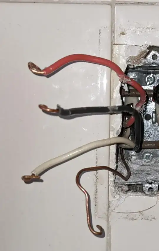

The wiring inside the box. Wiring inside the box

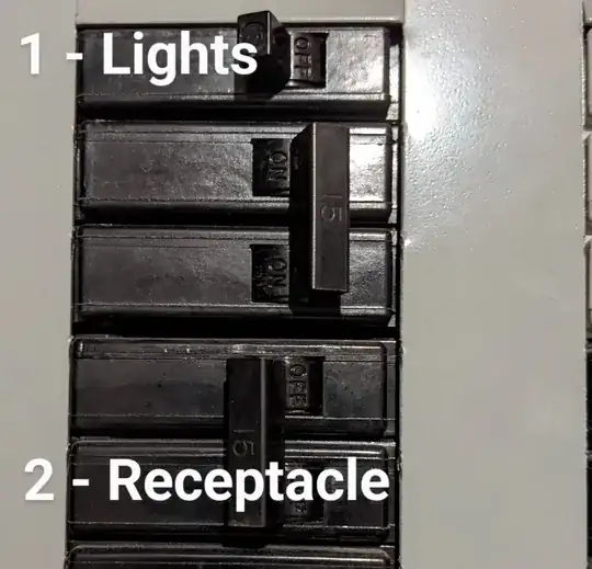

A picture showing the breakers placements. Breakers

This set of wires to be attached to the receptacle, right? I was going through my notes of the old set up where the red (top) & black (bottom) were wired at the back. I will be rewiring them on the sides this time to increase the reliability, so the red should remain on the top screw and black on the bottom? I will also break the tab in between the screws. MWBC wiring

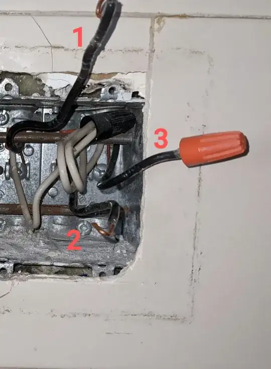

As for the other 3 black wires, I am a bit confused. So, I labelled them 1, 2 & 3 in the picture to get a better perspective. Switch wiring
Just wondering if I understood correctly, so the capped one (3) should be uncapped and wired to the switch?

  • Guessing the switch only had one wire connected to it. Very odd that a pigtail would come loose/undone at both ends(switch and wire nut). The black and red was probably joined together under one screw, that is usually not the proper way to do it, a pigtail is, since those screws not rated for two wires(usually). – crip659 Apr 09 '22 at 20:16

  • It looks like the small tabs joining top and bottom of old receptacle hot side is still there(it should be broken if on two breakers and all those hots). – crip659 Apr 09 '22 at 20:34
  • There's no "debris" in the sockets. The little white bits that you see in the slots are because it's a tamper-resistant outlet. See the oblong "TR" at the top of the outlet's yoke? It is a safety feature of outlets and depending on where you live it could be required by the electrical safety code. – RibaldEddie Apr 10 '22 at 19:00

  • The intent was posting the old setup image, not the envisioned result one, my apologies. – CecilG Apr 10 '22 at 23:35
Nice work figuring out which breakers they are. That is not an easy one to diagnose.

Since you have identified a 2-pole breaker for the MWBC, we can probably guess that both "hot wires" on the MWBC are connected to that breaker. So that confirms it is independent from the MWBC.

That would then suggest the /3 cable goes to the socket only, and that is the MWBC. Makes sense. If you hook red and black to the receptacle, you must break off the tab on the "hot" (brass screw) side of the receptacle. Otherwise, bang boom.
While one of the /2 blacks is over on the left side, I doubt it went to the MWBC. Both hot screws on the socket would already be used by red/black from MWBC.

On the switch wiring, I would expect having the 3 black wires separate has caused some unrelated loads around the house to break. Joining two of them (supply hot and onward always-hot) should restore power to those things. The remaining black wire is switched-hot to the fluorescent lamp.
That is another good use of a pigtail - to join the two "always-hot" blacks to a pigtail, so the pigtail can go to the switch. It's also possible to use the switch itself as a splice, by putting 1 wire on screw and 1 on backstab, but that involves using backstabs, which are unreliable.

Yes I think you have the receptacle wiring correct.
On the black wires to the switch, I'm not entirely sure which pair should be together and which one should be alone. But your idea is my first guess. Nothing should go boom if you get it wrong.

  • Turned out one of the black wires I guess is for the range hood as it no longer turns on now. Wondered if it was wired to the old receptacle, could it be possible? The wiring is all behind the tiles, I simply couldn't see which wire leads to the range hood. Guess only by trial and error? Also, how should be wired correctly in order to get this working again? Thanks. – CecilG Apr 11 '22 at 03:22
  • @CecilG See my edit. Yes, one wire is always-hot from that breaker, one is always-hot onward to the range hood, and one is switched-hot to the light. – Harper - Reinstate Monica Apr 11 '22 at 05:04
  • Where would the wire for the range hood should go in this case? As a backstab on the receptacle? It cannot be hooked up to the switch as it has its own switch. – CecilG Apr 11 '22 at 06:22
