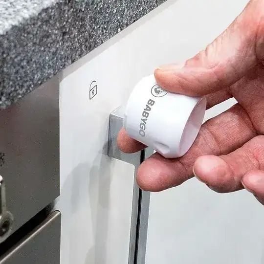

We have recently moved into a new house and our kitchen cabinet doors appear to have child locks fitted.
One of the cabinets has suddenly locked shut, and we cannot get it open.
These images show what the child locks in one of the doors which is opening/closing normally.
Any suggestions as to how we can get the cupboard opened?

Just found out that a magnet will unlock them! Used a fridge magnet and that did the trick.
The locks were something like enter image description here
these.

  • If you did not remove them yet (or do not need to use them), you should be able to "disable" the lock by flipping the hook latch up. Then you won't need the magnet each time. – Bruno L. Apr 11 '22 at 22:38
