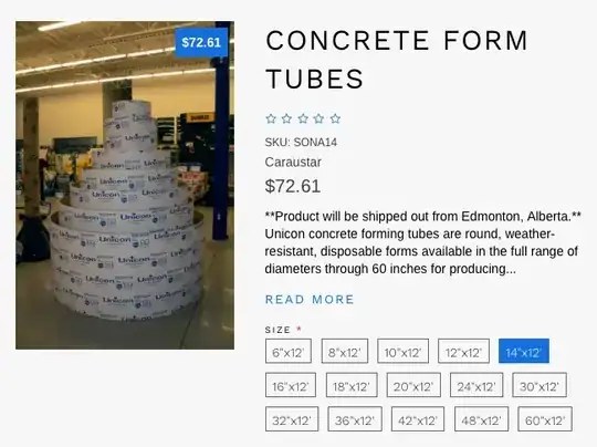

You could dig the trench in sections and use concrete forming cylinders, placed vertically, as trench plates.
These tubes can be lowered as you dig down, and pumped dry if water becomes problematic while you dig.
The round shape provides the kind of pressure support not possible with a rectangle: they are designed to hold the hydrostatic pressure of a 6ft column of wet concrete from the inside, but they are quite strong against pressure from the outside.
Arrange them side by side (touching), and when done digging you can drill through the cylinders to run the conduit. Or pre cut an opening at the bottom to run the conduit and later lift the cylinder. They can be cut with a box cutter, a drywall saw or of course a reciprocal saw power tool.
For a 4' creek crossing you'd need 4 such cylinders of course. A 12in diameter comes in 4 or 6 ft lengths, so you'd need two tubes total for 24in digging depth.
Divert the creek flow around the tubes, and work in sections if needed. The shape of the tubes will provide the required strength against the static pressure of the mud.
Digging 2ft deep inside a 1ft tube is not easy, but this could be a workable solution. Also, time is of the essence as they will not hold up forever against water.
These tubes have diameters up to 12in in box stores, but are available in larger diameters as well. The 12in tube weighs 7lbs for 4ft length.

  • It seems to me if I put them in place, on the bottom of any trench, drilling through them is going to be as tough as using my lateral bore, since I have to drill below the level of the creek water and groundwater. Am I misunderstanding how to do this? – Tango Apr 12 '22 at 03:50
  • @Tango the idea of trench plates is to hold mud up and be able to dig & pump the innards dry. I'd prefer a pre-cut notch (upside down "U") that is then plugged perhaps with a piece of tubing pressed from the outside. It won't be 100% water tight, but give you time to press the conduit through, one tube at a time. – P2000 Apr 12 '22 at 04:23
  • Aren't these going to be quite heavy and hard to handle? I would think if it holds back dirt, it'd have to be pretty strong, even if it's only holding back 2' of dirt. – Tango Apr 12 '22 at 05:17
  • @Tango, the round shape provides the kind of support not possible with a rectangle. A 12in 2ft tube weighs only 3.5lbs. I updated my answer, you can get them in much larger diameters too, which should make digging easier. – P2000 Apr 12 '22 at 06:03
  • I needed that visual. I totally missed your point and thought you meant to use concrete - which I can't do there, due to wetland regulations. This is intriguing. I can see what you're talking about but also imagine a couple other ways to do this. – Tango Apr 12 '22 at 06:13
