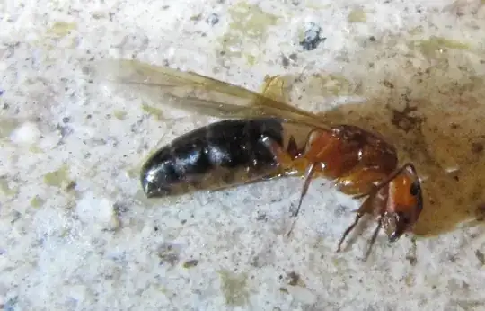

I just got home from work a bit ago and caught a swarm in the master bathroom. Among this swarm were 3 or 4 queens and several other swarmers. The queens were about 5/8" in length, where the swarmers were all 3/8" or shorter.
I've ruled out Camponotus pennsylvanicus based on the appearance of the queens. Their head and thorax are brown, and their abdomen is a banded brownish black. They only have one pair of wings and these protrude from their thorax. They are single-noded, which leans more towards Camponotus vicinus again.
Once I get the pictures off my camera, I'll post them here for further identification.
EDIT 2
Here's a cropped close-up I was able to get of one of the queens.

  • A picture of one of the queens showing the most detail can be found [here](http://i.imgur.com/b28ywdv.jpg) – Skudd Jan 29 '13 at 01:50
  • I'm not an expert, but are you sure that's not a termite? – DA01 Jan 29 '13 at 04:59
  • Positive. Check [this](http://www1.extension.umn.edu/garden/insects/find/carpenter-ants/) out for more information. – Skudd Jan 29 '13 at 12:48

    Turns out the colony was in a wall between two bathrooms (that should be a book title). I discovered this by watching their patterns and using a pipe inspection camera inserted in the walls. I was able to locate the nest and treat it myself with Termidor SC, per the label's recommendation. I left the wall open for a couple of days and used a shop vac to remove the nest. I've since roughed the drywall back in and haven't seen any sign of them. – Skudd Sep 17 '15 at 19:44
