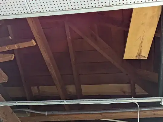

Sample photos of roof from underside; there is basically no ceiling - some junky ceiling tiles have been added in a few sections, but most is open from concrete slab to roof underside.

  • I uploaded some sample photos of underside of roof – Armand Apr 19 '22 at 15:34
  • From the photos it looks doable. In any case, dumping the hot air outside and keeping the top side of the insulation cooler than the roof should help a lot. I don't know if natural convection – bobflux Apr 19 '22 at 15:56
