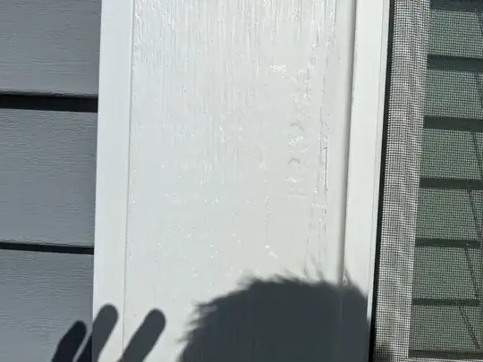

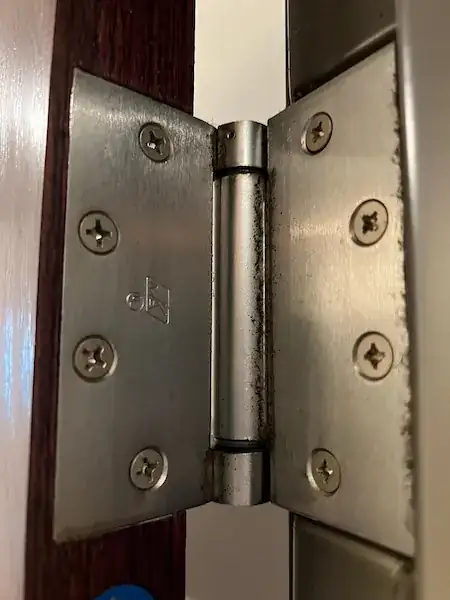

Here are some photos:
first photo of hingesecond photo of hinge
I can't find instructions for adjusting a spring hinge to plumb a door; all the McKinney and Everbilt spring hinge instructions solely describe adjusting spring tension.

I released the spring hinge tension and inspected behind the top hinge. There's a recess where the top hinge sits, and it uses 1/2" long machine screws to connect to a metal plate behind the steel jamb. The metal plate has some play, but not much. enter image description here
Here's a photo of the full hinge side, as requested. It's difficult to see the gap, but it widens from bottom to top by about 2mm (5/64"). I measured the gap with calipers:
  • 3.27mm at the very top
  • 4.03mm just above the top hinge
  • 2.97mm just above the middle hinge
  • 2.70mm just above the bottom hinge
  • 2.07mm at the very bottom
As you can see from the measurements, there's a bow out right where the top hinge is. This could be the culprit... if so, how do I fix it?

  • Thank you! I may need to post a followup question about releasing tension. Both spring hinges have two tiny holes on the side -- one near the top on the door side, the other near the bottom on the jamb side, both less than 1/16" -- with a coiled piece of thin metal inserted: https://imgur.com/a/DXCJ3wf The top of each spring hinge accepts a 5/16" hex key. I can turn the hex key clockwise but not counterclockwise. When turned clockwise, the socket recedes into the hinge and then pops back out. Nothing happens at the two tiny holes when I do this. – Jack Apr 21 '22 at 19:53

  • @isherwood You're probably right. The first hinge picture shows the leaf not even seated in the mortise of the jamb. There's got to be an adjustment somewhere. – JACK Apr 20 '22 at 19:33
As the top hinges do not close flush, but the middle non-sprung hinge likely does, then try swapping the top and middle hinges.
There is an opportunity to gain just a little bit of space, and it may just be enough to prevent the rubbing.
