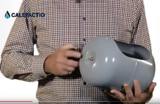

Just posting a screengrab from the Calefactio YouTube video showing air valve location on tank bottom, once you unscrew the round black plastic cover there to reveal it: (pictured tank has a cut out section to show internal bladder that holds the water)
