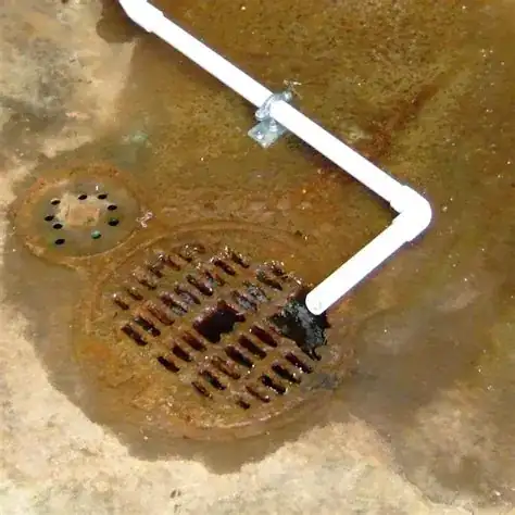

floor drain
I believe the source of this smell is this. If you have any drains like this in your basement, pour some hot bleach water down them.
I believe we don't smell it as much here during the winter because the ground is frozen.
Maybe have a plumber come out with a camera and snake the plumbing to see if anything is wrong.
Andrew
    The question states that the smell goes away after a few days. That makes the drain theory unlikely. – Chenmunka May 16 '22 at 06:23
  • Sorry, I forgot to mention that I have a condensate pump that pumps the water 20 feet away from the furnace. Good theory though! – MonkeyZeus May 16 '22 at 10:36
