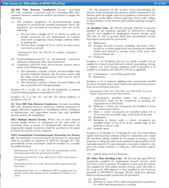

Okay, I will answer my own question in the hopes it might help someone else. YES, all outlets within six feet of a sink must be GFCI see https://www.nfpa.org/codes-and-standards/all-codes-and-standards/list-of-codes-and-standards/detail?code=70

    The screen shot is better than just a link, however, it's difficult to read, and impossible for those with vision issues. If you'd copy & paste actual text from the linked code section, that would be even better. – FreeMan Apr 28 '22 at 15:28
    Good try but that is only if your jurisdiction is following the NEC, for an example my jurisdiction (Oregon) only requires GFCI’s on 15 & 20 amp circuits (not 250v) , the second exception is for equipment in a dedicated space or difficult to move such as a refrigerator or freezer, I think it is ridiculous to put motor based equipment on GFCI’s as they regularly trip and fail much more often inrush and inductive kickback. The last exception is loads known to have issues , well just as I said Refridgeration equipment has issues with electronic breakers so if in my jurisdiction, no not required – Ed Beal Apr 28 '22 at 15:41

  • @FreeMan I've tried and failed to find a way to copy and paste from the NFPA website, maybe it's just me. If you know how could you share it? – NoSparksPlease Apr 28 '22 at 16:31

  • Unfortunately, @NoSparksPlease, the link doesn't take me to the specific section the picture shows, so I can't give it a shot. Maybe if there was a link to the specific section, or the section in question was at least listed, I'd be happy to give it a shot. – FreeMan Apr 28 '22 at 18:05
  • @FreeMan You can if you create a profile, it was free when I signed up. It is a little clunky. https://www.nfpa.org/Registration?RefUrl=https://www.nfpa.org/NFPA-Membership/Membership-resources/Member-Sections?order_src=G054&gclid=EAIaIQobChMI_P3qmbm39wIVHcLCBB1ByQTBEAAYASAAEgJncPD_BwE – NoSparksPlease Apr 28 '22 at 19:07
