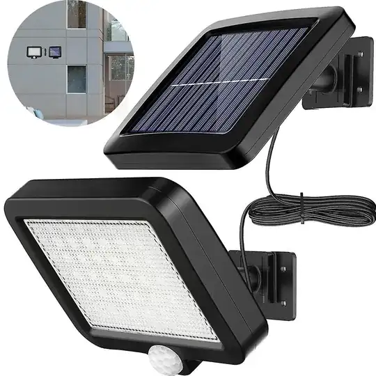

If you just want people to not trip, I'd suggest one of these sensor LED lights on either side. They charge well enough, and only switch on for motion then stay on for about 2 minutes. The battery lasts at least 3 years and the units are cheap.

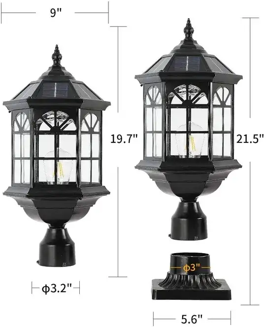

But I suspect you want to power the existing light fittings. In that case, I'd suggest getting a solar-powered security light that has a flat solar panel on a wire. These are intended so the lamp can go where it needs to, but the panel can be some distance away for better angle and insolation. Something of this design:
General image
There will be a lithium battery somewhere, probably behind the LEDs and not in the solar panel itself. I'd get two (maybe a third as a spare) and then open the unit.
Figure out the voltage it drives the LEDs at and see if you can get an LED lamp/bulb for your existing fixture that suits. If not, I'd look at rearranging the entire guts of the light fitting with the LEDs inside your existing housing, the motion sensor aiming toward the steps, and the solar panel in the best place for sunlight.
I know you said "you don't get a lot of sunlight" which suggests this area might be in shadow a lot. That's okay - modern solar panels will produce voltage even on cloudy days.
The upsides are overall price savings compared to the long run of mains cable, and its a completely autonomous independent system separate from your mains electrics.
Downsides, it needs effort on your part to make something nice-looking here, and there will be a solar panel hanging out somewhere. Perhaps angled on the capstone, or on the sunward face of the stone pillar.
Last resort is to replace the mains-powered pillar-topper fittings pictured with something designed to be solarised. Think nicer than those nasty garden-edge solar spike lights. Example: enter image description here

    Just a quick look and I found a fixture that will hold 3 candelabra bulbs (below). 60W equivalent LEDs draw 5W apiece. Good for 14 AWG? https://www.lowes.com/pd/Kichler-Linford-180-Watt-22-13-in-Olde-Bronze-Antique-Traditional-Post-Light/50356214 – RetiredATC May 10 '22 at 02:32
    Two fixtures, 3 bulbs at 5W each per fixture, 30W total, a whopping 0.25A current at 120V. 450 foot distance, 14 AWG copper, 119.29V delivered at the end of the wire... – Ecnerwal May 10 '22 at 03:07
