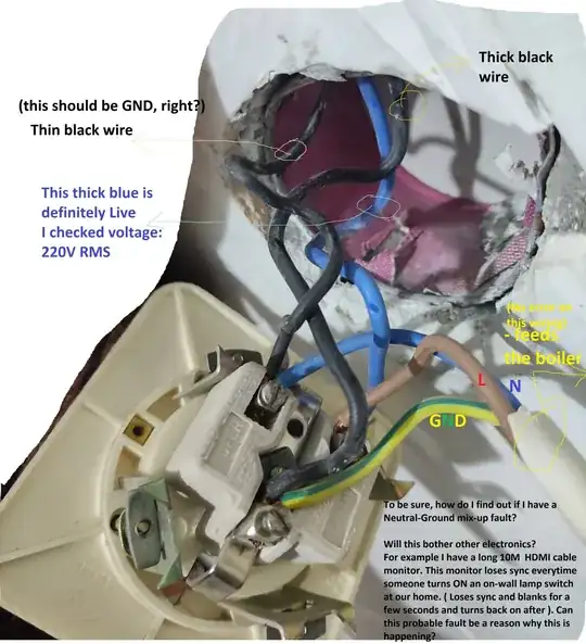

When we moved to a new house I noticed a strangely wired up outlet:
Outlet Wirings - Spliced white wire goes to provide electricity to the boiler
For this outlet, I am really suspicious whether the grounding is messed up and mixed up with the Neutral.
Normally Neutral and the Live wires are the thicker ones right? If that is the case this outlet is violating that and the whole houses ground connections will have leaking voltage right? When I measured some of the grounded equipment I saw the line's tester's light is turning on and saw some nonzero voltages(for example my PC case).
Apparently to save one outlet somebody directly used that outlet and extended a wire into the balcony which feeds the central heating boiler of the house. If the wiring is wrong how is the breaker not tripping? Isn't this extremely dangerous the boiler sending its current back from the ground path?
-- To be sure, how do I find out if I have a Neutral-Ground mix-up fault?
On a side note, will this bother other electronics? For example I have a long 10M HDMI cable monitor. This monitor loses sync everytime someone turns ON an on-wall lamp switch at our home. ( Loses sync and blanks for a few seconds and turns back on after ). Can this probable fault be a reason why this is happening? For reference the German standard for electrical wiring (my country uses the same Page 14-15 of : [this IEC related document] 2 ): German Standard Example home wiring

  • @NerdyNerdie But Neutral and Earth **must** be connected together, so it's not only normal, it's mandatory. It would be not at the socket but somewhere upstream in the electrical system. Are you sure it was a qualified electrician? Maybe you should get another. –  May 16 '22 at 18:15
  • It's quite unclear which wires are input to outlet, and which are output to somewhere else. What is the white cable with blue/brown/yellow-green? –  May 16 '22 at 17:31
  • @Justme White cable goes to feed the boiler. Yellow-Green is standard for its Ground connection. Brown has to be its Live wire. Blue has to be Neutral. Blue coming out from the wall, on the other hand, is Live - ( the color standard is different there) –  May 16 '22 at 17:46
  • @jsotola Isn't this the electrical engineering section? I want to learn how one detects if the GND and Neutral is mixed up or not. Without breaking any more things of course. I don't want to directly switch those wires and try since I don't know the extent of the danger. They both stand at 0V normally but since I don't have a GFCI breaker, this doesn't create a direct red-flag that sth is connected wrong. A GFCI breaker would definitely pop up if you mix GND and Neutral. –  May 16 '22 at 17:58
    you may be in a country that does not use a neutral ... an electrician from your country is very likely to read your question on the home improvement site – jsotola May 16 '22 at 18:02
  • @jsotola My country uses European standard. Earlier I called an electrician . He just tried to make a connectivity check (with a multimeter) and said something somewhere is wrong in wiring of the house. Connectivity check everywhere on every outlet showed/shows GND and Neutral is shorted (Buzzer beeps). –  May 16 '22 at 18:06
    if the neutral and ground are bonded at the breaker panel, then that is exactly what a continuity buzzer will do – jsotola May 16 '22 at 18:10
  • you really need to provide a link to your country's electrical code so that it can be examined – jsotola May 16 '22 at 18:14
  • This website might help you understand house wiring a bit better. Unless you already know more than this. http://hyperphysics.phy-astr.gsu.edu/hbase/electric/hsehld.html#:~:text=The%20standard%20U.S.%20household%20wiring,the%20other%20is%20swinging%20negative. –  May 16 '22 at 18:22
  • @NerdyNerdie You already knew something was wrong with the wiring of the house ***before*** you called in an electrician. You didn't know why. But you knew you had to be right about that fact given your observations and what you know to be reasonable expectations. The electrician merely confirmed your suspicions, which only means you are probably not insane since another conscious and hopefully more informed individual arrived at a similar conclusion. But you learned nothing new. A helpful answer will require specific details. You will need to open your hand. No other way. And even then... – jonk May 16 '22 at 18:27

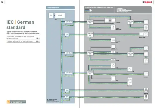

  • @jsotola I found some IEC related document about the electrical code and appended it to the question . But it seems shallow for my purposes. Page 14-15 https://www.legrandgroup.com/sites/default/files/Documents_PDF_Legrand/Nos_solutions/Guide_International_standards_EN.pdf –  May 16 '22 at 18:30
  • @Justme Let me ask this way: Even when the breaker is popped OFF, is this the case? (i.e., Earth and Neutral being bonded) –  May 16 '22 at 18:32
  • @KoolBreeze I think this is US standard. How different this is from the German standard? (240V receptacle and two hot wires is not the case in the German one.) I can see the Neutral and Earth bond there. – NerdyNerdie May 16 '22 at 18:46
  • @jsotola So even if Earth and Neutral are mixed up it is okay? But then why does the standard even require the need to split Earth and GND - 2 wires instead of 1 everywhere? – NerdyNerdie May 16 '22 at 18:47

    Neutral and ground are to connected together only at the main panel, nowhere else, not at outlets, switches, lights or sub panels. I think Europe changed their colour scheme years ago, so you will need to see the old colours to see if black was used as neutral or ground, think bare or green with/out colour is the only colour for ground everywhere. – crip659 May 16 '22 at 19:00
    @NerdyNerdie You need to tell us which country this installation is in if you want help. Whilst the boiler cable uses modern IEC colours the fixed wiring doesn't use either new or old German wiring colours. – Graham Nye May 16 '22 at 19:03
  • I think only someone with very local knowledge will know if blue for hot, black for neutral and thinner black for ground is normal and correct for your location. And you are more likely to get that by finding an electrician's forum in your local language and region. In general, to tell if ground and neutral are mixed up .... if you have an RCD it should break ... unless the wires are mixed up there too. If not, you have to disconnect wires at the panel and take voltage and continuity tests. – jay613 May 16 '22 at 19:14
  • Having worked in a couple of countries I can tell you that the the electrons don’t care what color the insulation is. Is a ground larger or smaller than a neutral ? Not in the smaller sizes they are usually the same in smaller cables as the sizes get larger the neutral a normally current carrying conductor can be larger than the ground but tithing says that it has to be larger being the same size s fine and if larger it would be silly. As for your cord to the boiler green/yellow is the ground or earth, blue is the neutral and brown is the hot but DIY may not have known and electrons don’t care – Ed Beal May 16 '22 at 19:49
  • A simple way to answer this is with a question. Do you have an RCD? If you do and are not tripping out when the boiler is running don’t sweat it. In the UK I know color codes have changed over the years but if electrically correct who cares unless you want to update everything. – Ed Beal May 16 '22 at 19:56
  • Do the two black wires and the accompanying blue go to another receptacle? Are the three wires on lower right coming from the panel (consumer unit)? Does the "boiler" plug into this receptacle? Perhaps the three wires going to upper left should all be reconnected: blue for neutral, heavier black for hot and smaller black for earth. Then makesure the next receptacle is wired consistently – Jim Stewart May 18 '22 at 01:44
  • @crip659 besides this not being the case in the OPs case, this statement is not quite correct. in old german installations (pre 73) you often have what is called "klassische nullung" where only one PEN is fed to each outlet etc. – PlasmaHH May 18 '22 at 10:16

Neutral is not Earth
They are completely different wires with completely different jobs. Neutral is the normal everyday path for return current. Earth is a fault catcher, it only flows current when a fault of some kind is happening (and stops as soon as current trips the circuit breaker or RCD/GFCI).
Putting active daily current on earth is out of the question.
I see you using 'GND' to describe "Ground" as you call it, which tells me you've cut your teeth in small electronics. That is a completely different world. In electronics there is no proper earthing, and "GND" is simply the negative/Vss/backplane/common that is wired to everything as the common return loop... which would make it more like AC mains "neutral".
I gather you're from the Euro-system of wiring, which means, you call that thing EARTH. That is a relief: over in North America we call it "Ground" which makes it much harder to RE-train electronics folks. So keep calling it EARTH, or at least as "safety ground" as a different thing from GND.
I never call it GND, and I'm a Yankee.
Also unlike electronics, neutral is not "common" either. In AC mains we are running the wires at hard ampacity limits all the time, which means, each live supply wire MUST have a dedicated neutral wire that returns only its current. We can't be careless and treat neutral like a common/backplane, because then, 1 neutral might end up returning current for 2-3 live wires, and it would be overloaded! Neutrals don't have circuit breakers - they don't need breakers if wired correctly. (even on an RCBO, the neutral goes through the RCBO for RCD sensing, but does not have its own overcurrent detector).
Earths are yellow/green
Or straight green, or bare. This is a world standard and is largely effective outside the old Soviet bloc. Even the Yankees agree on it!
Very much unlike neutral, all earth wires should be tied together in all locations. Since earth doesn't carry current except during fault conditions, we don't need to worry so much about thermal overloads from continuously carrying high current. Service current is never on earth.
Find out about local legacy neutral and earth colors
I've never heard of a country where they used the same color for both neutral and earth at the same time. However there have been changes.
  • Modern Euro/3-continent standard: Light blue for neutral, brown for live
  • Au, NZ and old UK standard: Black for neutral, red for live
  • Americas standard: White for neutral, black for live
So you will need to ask local experts for the old wire colors, and see if that explains what you see.
Prepare for the possibility that your old work was done before earthing became a standard, and there may be no earth at all. Also, some locations used metal conduit for wires, and in that case the metal conduit is typically a valid earth!
Test the neutral by isolating it
Neutral has an equipotential bond with earth, either at the panel/consumer unit or on the power company side of it. This is to keep voltages at a reasonable voltage and to suppress transformer leaks, lightning etc. It also gives a current path for fault current to complete its circuit. Do not treat this as a license to treat them as equal or to tie them together elsewhere!
Once you know which circuit you are dealing with, and can identify the circuit breaker that turns it off... if you are qualified to do so, you can go into the breaker panel (consumer unit). From the circuit breaker you can identify the circuit's live wire, and then identify the circuit's neutral. With the breaker off, you can disconnect the neutral from the breaker or neutral bar.
Now there should be no connection between neutral and earth. With the circuit breaker off, live+neutral (together) should be isolated from earth.
You can also try energizing the circuit with neutral disconnected. In that case, on a properly isolated circuit,
  • neutral will be isolated if all loads are off (a DVM will show a phantom voltage of a fraction of normal voltage).
  • if any loads are turned on, neutral will snap to line voltage (e.g. 230V) in all locations. That is one reason the neutral wire is insulated.
  • All loads should be inoperative. If you find a load that is working, it is bootlegging neutral from earth.
If you find yourself with an earth wire which is not plainly marked (e.g. it is the wrong color, or the former earth color is now a neutral color etc.), then wrap it with green or yellow/green electrical tape at the least. That is not authorized by the electrical code, but it will make it clear what it's being used for. Identify the wire carefully and always mark both ends of a wire the same, at the same time.

An RCD in circuit should have tripped, had neutral and ground got swapped in the outlet in question.
Here's a way to check for the swap.
  1. Switch off the main incoming 2-pole circuit breaker. That would isolate the line and neutral from the house wiring.
  2. Check for continuity between the neutral point of that outlet and earth point of another.
  3. Then check for continuity between the earth point of that outlet and the neutral point of another.
A positive result in the above two checks would confirm the swap.

There is no easy way to diagnose a swapped neutral and earth.
  • Plug in detectors are unable to detect neutral-earth swap.
  • Earth and neutral should be bonded on the house side of the disconnect switch. So opening this switch will not help to resolve a fault)
Two relatively non-intrusive tests:
  • If there is a RCB, RCBO, ELD on this circuit and it is not tripping then the wiring is ok. These detect either the balance between currents into hot and out of neutral, or the presence of a current on the earth.
  • If a clip on current meter is available then it may be possible at the switchboard to compare current in hot with current in neutral.
Other tests involve disconnecting wires at the switchboard and should be done by an electrician.
