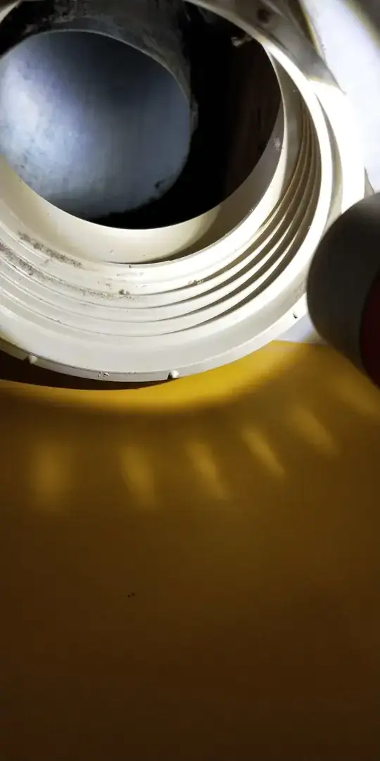

Ceiling - duct joint that leads to the roof cavity Ceiling - duct joint that leads to the roof cavity
Inside of duct joint, and pipe to roof vent you can see about 5 cm away Inside of duct joint, and pipe to roof vent you can see about 5 cm away

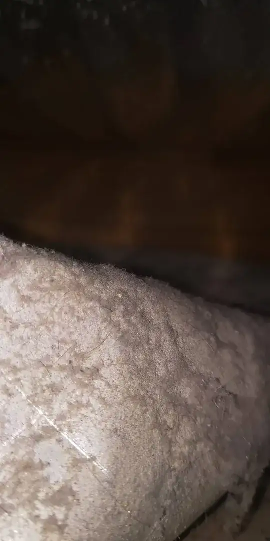

insulation in flat roof insulation in flat roof

Long story short, you're going to want to figure out a way of connecting the ducting from the dryer to the ducting through the roof.
If you don't, you're going to end up with warm, moist air feeding mold growth in your attic, and you're going to end up with an attic full of lint, which is a fire hazard.
The vent through the roof is simply acting as a roof vent similar to the other roof vents you've got. It will do nothing special to vent your dryer until it's directly connected.

  1. Noting just how close those are (you indicate 5cm), a piece of flex duct will probably be your only option to use this as is. You're just going to have to figure out how to get into this area of the attic and get the ducts connected.
    • It may be possible to place two large hose clamps around your flex duct then put the flex in position and slide the clamps down around the solid ends and tighten with a screwdriver bit in a powered driver (much easier to operate one-handed in a cramped environment).
    • Even better than a Phillips driver bit would be the appropriate sized nut driver - it will hold on better and be easier to keep connected. (Note: every hose clamp/jubilee clip I have seen has a combination Phillips/hex head where either type of driver will work. YMMV.)

  3. If neither of these are workable, you may just have to bite the bullet and tear into the wall/ceiling to relocate the duct collar inside the house so that you can connect the duct work in the attic. The connection inside the laundry room is the easy one by comparison.
    • While this may seem to be a pain, repairing/patching drywall isn't a totally horrible experience and may be easier than squeezing into a rough/tight space in the attic. Plus, you'll learn how to repair drywall and will have a new skill for the next project you need to tackle.
