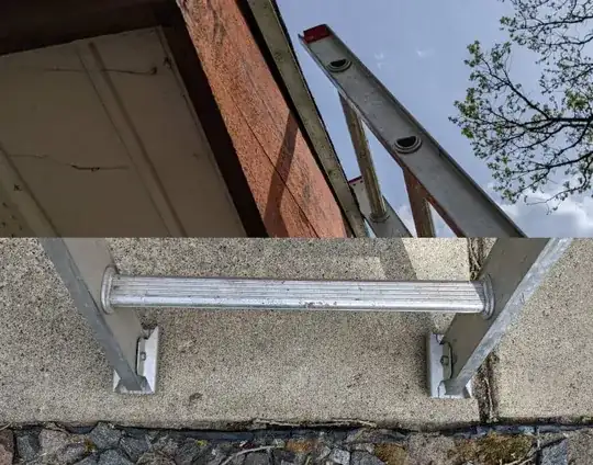

I cannot come up with a reliable way to keep the ladder steady when it's leaning against the shed roof. I need to paint the trim two storeys up. When the right side of the ladder touches the roof edge at the point indicated by the arrow in the sketch, the ladder's left leg comes up off the ground a few inches. The ladder is then a-kilter, standing on one leg, and I'm concerned it will slide down the roof with me on it.
Is there something painters rig up to solve this problem, short of scaffolding? Something more reliable than a couple of bath towels draped over the drip-edge?

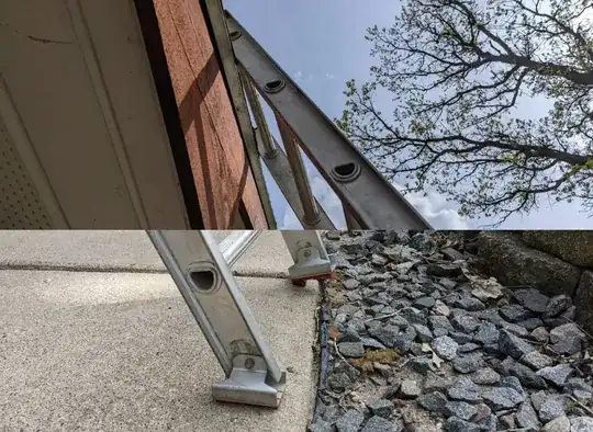

Scaffolding would have been the safest solution, but it was hard to find one in a timely rental (and it's in the back yard and inaccessible to a cherry-picker). I managed to jerry-rig a solution to the tippy ladder problem. My son said to me, you don't want to hear 'jerry-rig' and 'ladder' in the same breath. But the clamps actually held the ladder quite securely.

Rotate the bottom of the ladder toward the downslope a bit, and shift it the same way. Let's not overcomplicate things. That's all it takes. It would be counter-clockwise in your diagram.
It may seem like this creates a tilt in the ladder, but that's actually how things are in balance. All four points of contact are stable.
Here are the various situations demonstrated on a 6:12 pitch roof and level slab...
1. Ladder leaned square with wall, bottom parallel to the wall, top gapped on one side
2. Ladder leaned square with wall, bottom gapped one side, top tight
3. Ladder skewed with respect to wall, bottom rotated and shifted, top tight
#3 is clearly the ticket. This arrangement can be found for any roof pitch, assuming fairly level ground, though at some point things get weird and potentially unsafe (beyond maybe a 10:12 pitch).
If you can't get this to work with just a slight side offset, your ground surface is probably out of level. Use a scrap of wood or masonry to add height as needed, or dig a little divot. Be sure it's not slick, and don't stack things unless you fasten them together. They'll tend to slide when you don't want them to slide.

  • I tried this approach but the ladder's legs are never both solidly on the ground when there are two points of contact at the roof. – mr blint May 24 '22 at 14:46
  • I think it's the drainage slope of the patio, probably 1/4 inch per foot. – mr blint May 24 '22 at 15:03
    Then you need to shift the bottom sideways more. Find the right combination. – isherwood May 24 '22 at 15:19

My jerry-rigged solution was to clamp an "outside corner" length of wood to the roof and then to clamp the ladder to that piece of wood. You could make one of these pieces by sawing out a section of a 4x4 post to get an "extruded" L-shape.
My feet were on a rung only about 8 feet off the ground. Had I needed to go any higher than that, I would have waited until a scaffold rental was available locally.
I tested this rig to make sure it was secure given my particular set of circumstances, but the safety of this sort of hack depends on the clamping force of your clamps and on the nature of the task.
