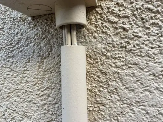

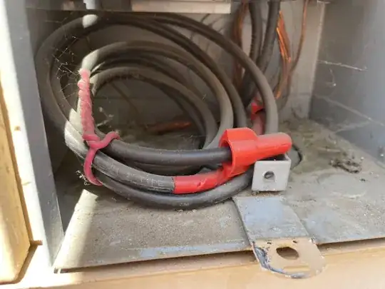

There's a set of exposed THHN cables before they enter a junction box below my home's load center. The wires are currently capped so I wanted to know what the risk was of having this gap when/if the wires are live and what I can do to remediate it.
junction box before load center
close up of gap
capped ends inside load center

  • In photos 1 and 2, is the insulation damaged even with the top of the pipe? Can't tell if its abrasion through insulation, or just paint. If its damaged, then you may need to pull the wire for replacement or at minimum for sealing each with suitable heatshrink. – Criggie May 28 '22 at 22:55
14
The conduit entering the box evidently needed, but someone thought it didn't need, an expansion fitting. They appear to have also skipped glue, as I don't see any remains of glue or broken conduit in the hub.
An expansion fitting is just a long sliding joint with hubs on both ends. Adjust it to the middle of its range (make a mark), pull back the wires so you can cut the conduit to install it, cut out enough conduit to provide space for the expansion fitting, cut a stub of conduit to glue the one end of the fitting into the hub on the box, and glue the other end of the fitting to the conduit in place. You can do that because the fitting slides, as it will in use.
Then pull the wires back in.
From looking at your pictures in the question it is not certain just where the vertical conduit below the box terminates at the lower end. I bring this up because it is possible that the conduit extends down into the ground.
It is possible that at one time the gap was not there and the conduit mated into the fitting on the box. The ground near the side of the building may have settled over time pulling the conduit down at the same time. If this is the case it may be a simple fix to dig down around the conduit to the extent that it can be pulled back up enough to close the gap. In doing so it would be necessary to backfill around the conduit in a way to support it so it stays up. This would be especially important it the portion of the conduit has a turn and travelled horizontal below grade.

  • I added another picture that shows the conduit going into the concrete on the ground. It would be a major project to dig that up so now I'm wondering if this is even salvageable based on the other answers. Thanks. – user2558617 May 28 '22 at 03:55
    Yes, it's salvageable. Scraping paint off conduit (for the distance required to make a glue joint) is not that big of a deal. For that matter, PVC cleaner may just peel the paint right off, if you follow the cleaner/primer/cement path to good joints - worth a test, anyway. – Ecnerwal May 28 '22 at 15:02

  1. The main risk on the uncovered wires is damage. If something hit that wire just right, it could penetrate the insulation and kill someone. Even though THHN is hefty stuff, I would try to protect it somehow. Either lower the box or pull it off so you can add a proper extension. Looks like PVC conduit so not expensive to do either way

This is very bad, and was "amateur hour" from the day it was built, and you can tell because it was like that even before the painters arrived. The builder should be held accountable.
You will need to disconnect the 4 wires from wherever they are attached (whichever end is most convenient), straighten them out, and overlap one of the wires with a pulling rope for about 12 inches. Aggressively lash them together with tape so they can't pull apart. Then lash the other 3 wires to the bundle, and tape down the ends so they can pull easily.
Now, pull the wires back so they are clear of the work area. Make full use of all existing pulling points (e.g. an LB on the interior). To the extent practicable, work around the rope.
You may need to pull the rope through this box to replace the box, since the lip of the hole is now contaminated with paint, and won't fit the pipe anymore. (unless you want to lay there on your back with an exacto knife chiseling all the paint off the interior of the port, yikes). Cheap plastic box (cheap in quality), they don't age well.
Then dig up the conduit below the ground (to where it isn't painted) so it will fit in PVC fittings and be glueable. Unless you want to painstakingly strip paint off PVC without damaging the PVC! Better to go a bit below ground.
Then replace the PVC vertical run with Schedule 80 PVC, which is what should have been used in the first place. You'll have to go to an electrical supply or good lumberyard for that, box stores don't sell it. This time, properly fit it all the way into the box! And make sure the vertical run has an expansion joint, installed per instructions.
An expansion joint is a trombone slider that allows for pipe movement due to thermal expansion and settling. Place it so it's halfway (not at one extreme or the other, that would defeat the purpose).
Once everything is fitted up, glue it up (otherwise the expansion joint will let the pipes slide out).
    It is possible that the painters were doing a spray job to re-paint the house / building years after that electrical box and conduit was installed. – Michael Karas May 28 '22 at 09:10
  • It's likely that the conduit was in (but apparently not glued, or not glued well at all) the fitting when the place was built, settling occurred and pulled it out, (which is why we use expansion fittings, especially in places with freeze-thaw) and then the house was repainted one or more times over the decades. – Ecnerwal May 28 '22 at 15:11
    @Ecnerwal true... although PVC is not glued, it is welded. The "glue" is solvent which melts the plastic and causes it to become one piece of plastic. I would expect any parting to be extremely gory. – Harper - Reinstate Monica May 28 '22 at 20:02
