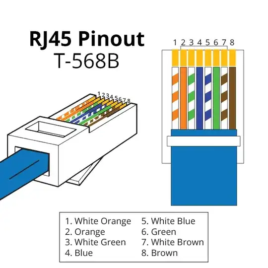

Follow the basic code for residential ethernet pairs if doing things in the home. FOLLOW THE DIAGRAM BELOW TO WIRE RJ45 END
Hope that this is helpful you should notice one end or the other end skipping pairs if things are right with your cable tester or jumping around check and double check it is most likely the way you wired your ends!
forlotto
    Note particularly the *oddball interposition* of blue and green on pins 3-6. It would be very easy to get that wrong. (it's a throwback to telephone design, where the RJ11 had line 1 on the 2 center pins, and line 2 on the next pair outward). – Harper - Reinstate Monica Jun 01 '22 at 20:45
