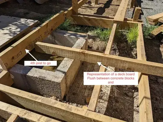

I have built a small formal pond out of concrete block. I have also constructed a deck frame which part crosses the formal pond. Visually, I intended for it to appear that the water disappeared away under the deck.
There are 4 joists for the decking. Three are connected to the deck frame in the usual way. One joist however has to cross the pond. The height of the pond is the same height as the deck frame, so the deck boards are just above the water surface. On reflection, this was an error!
I am now stuck with how to support the deck boards where the fourth joist should be between the two sides of the pond. I can only think of two options:
  1. Submerge a joist and somehow fix it within the pond. However, this is likely to rot quickly and will spoil the illusion that the water is disappearing under the deck.
  2. There may be another material I could use to bridge the gap. I wonder if a steel flat bar would do the job, secured either side of the pond to the top of the concrete block.
Hopefully the picture below makes it clearer.
Diagram demonstrating where the fourth joist is missing
Picture showing the issue

  • Could you provide a picture of your actual situation? Your picture does not match your description of "The height of the pond is the same height as the deck frame, so the deck boards are just above the water surface." – MonkeyZeus Jun 02 '22 at 15:39
  • @isherwood no railings or anything above. The end result will be that the deck is level with the ground around it. I've added a picture. – Chris Evans Jun 02 '22 at 15:40
    @MonkeyZeus I've added a picture to make it clearer. The top of the concrete blocks is at the same height as the top of the deck frame. Thus the deck boards sit just above. Hopefully that makes more sense? – Chris Evans Jun 02 '22 at 15:41
  • Yes, the second picture is 100x more useful than the first. In fact the first does more harm than good. – MonkeyZeus Jun 02 '22 at 15:42

  • Your first diagram is confusing because one of your joists appears to go over the formal pond! – Tim Jun 03 '22 at 20:55

  • No dimensions rule out a good answer notching the blocks may be a way to go but it looks like the pond height or deck height need to change. – Ed Beal Jun 06 '22 at 04:42
I think I'd use a length of aluminum box tubing as a joist. You can hang it on the concrete using segments of aluminum angle as joist hangers. You can then screw the decking directly to the tubing.
    I think this would work nicely. Rather than fixing it to the concrete, I could take out a small chunk of the concrete block for it to rest in either side which would give a very sturdy support. – Chris Evans Jun 02 '22 at 15:51
  • @ChrisEvans, how would one notch concrete squarely and precisely for that? A couple expanding anchors would make quick work of it. – isherwood Jun 02 '22 at 17:50
    @isherwood concrete block and will be hidden. I imagine I should be able to cut out a small section with an angle grinder and back fill with cement to hold in place. I won't be able to put expanding anchors on the inside as the pond liner has to go in, so would result in a hole through the liner. – Chris Evans Jun 02 '22 at 21:15
