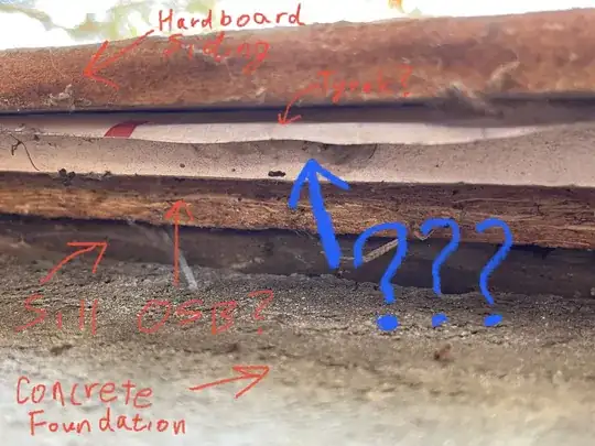

My house is in Northern California and was built within the last 15 years. I'm pretty sure I still have the original siding, which is hardboard (a.k.a. engineered wood). I've read that house exterior typically has 3 layers -- sheathing, a water barrier like Tyvek house wrap, and the siding. But when I looked under the siding, there are four layers. Please see the attached photo, which was taken from the ground looking up. What's this pink layer (pointed by the blue arrow)?
You can see the concrete foundation and the sill (pressure treated wood) sitting on top of it. Going from inside to out, the very first layer looks like OSB sheathing, and then the unknown layer, and then a very thin layer (which I think is Tyvek house wrap), and then the hardboard siding.
I think this pink thing might be a rigid foam board for exterior insulation, but it's only about half an inch thick (just like the siding and the OSB). Aren't foam boards for exterior insulation usually at least 1" thick? Thank you.
photo from ground looking up behind the siding

It's gypsum sheathing, and it's white (as is the Tyvek). Your camera's white balance is off. In the full-res photo you can clearly see the porous texture and paper facing. Here it is looking a little more natural.
I'm not familiar with fire protection practices used lately in fire-prone areas, but I'd guess it's intended to retard fires that occur on your siding.
  • Thank you! That makes sense to me. Unfortunately, it looks like those don't have a high R value. – James Jun 02 '22 at 21:48
  • No. It's not intended to be insulation for energy efficiency. I assume your home was built to modern standards, though, with at least R-19 in the walls. – isherwood Jun 03 '22 at 12:36
  • Depending on how it was installed, there may be some significant air sealing benefits (i.e. if the edges are taped together and sealed at windows/doors). – LShaver Jun 03 '22 at 17:41
  • @LShaver, that's the primary purpose of the housewrap. Taped joints would be redundant. – isherwood Jun 03 '22 at 17:57
EDIT: Most likely isherwood is correct that it's a gypsum layer due to fire codes in this case, but as rigid foam is a good possibility in other cases, I'll leave this answer in place.
That is most likely rigid foam exterior insulation, as shown in this schematic from the Oak Ridge National Lab Foundation Design Handbook:
