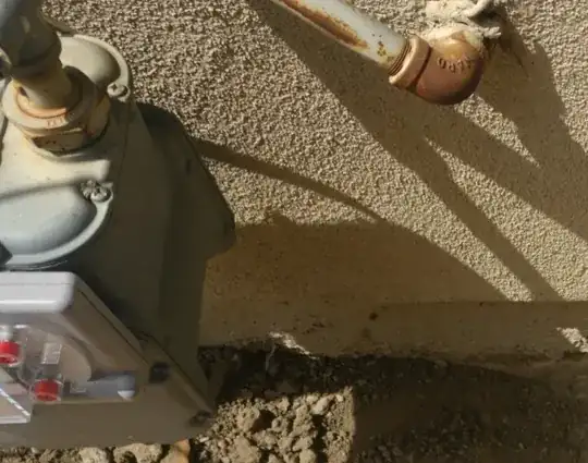

One of the posts for my fence rotted away underground to where the post above ground could be simply pulled out. I fixed a ring with some lag bolts to the top of the remaining post (which is about 3 inches below ground level) and used a 7 ft pry bar to try to rip it out of the ground, but it turns out that the cement for the post was connected to the foundation of the house, so it's not going anywhere.
Beneath the initial rot, the post is still strong, so I can't break it up and pull the pieces out. I can't get tools like my drill deep enough to cut into it either. Maybe there's some tool purpose-built to drill/cut into the post, but I'm sure it'd be more expensive than I'd like to take care of a single fence post. The only other option I can think of is burning the remaining underground post away, or at least enough to compromise its structural integrity enough that I can pull it out.
Is there any concern / risk with doing this? The surrounding area is just dirt / concrete -- no grass or plants. The ground is extremely dry, though the fence post has naturally absorbed a bit of water in order to rot like this. The exterior wall above the hole is stucco. There's nothing flammable except for the fence post. I presume I should be using wood/similar based fire starters rather than gasoline given the plethora of gasoline-fire-starting mishaps documented well across the internet :)

    The stuff shown in the bottom picture(grey box, pipe, gas line?), might not like fire too close. – crip659 Jun 05 '22 at 22:46

  • Yeah - buy or rent a bigger drill (or drill bit. or drill bit extension) is the right approach here. Particularly given the pipe and meter you show but don't think is worth mentioning is right next to/above it. – Ecnerwal Jun 06 '22 at 02:56

Even if the gas line WASN'T right there, the heat from burning it out would damage the concrete you are evidently trying to save.

Is that a gas meter and gas line ?
Know this: if you pour gasoline or any other flammable liquid in the hole and then light it, there will be a combustion EXPLOSION. Which will destroy your gas meter, which will destroy the wall to the neighbor and you home.
gas

    +1 for not burning things next to the gas line/meter! Not sure about the chain saw recommendation. I see where it _could_ work, but a chainsaw with a 36" bar isn't exactly cheap nor easy to yoink around... – FreeMan Jun 06 '22 at 12:19
    I have to chime in: I don't like the _"stick a long chainsaw in the concrete"_ idea as much as I don't like _"set a fire under the gas meter"_ idea. Both seem to be potentially catastrophic. **Don't do either one of those things!** – gnicko Jun 06 '22 at 14:10
