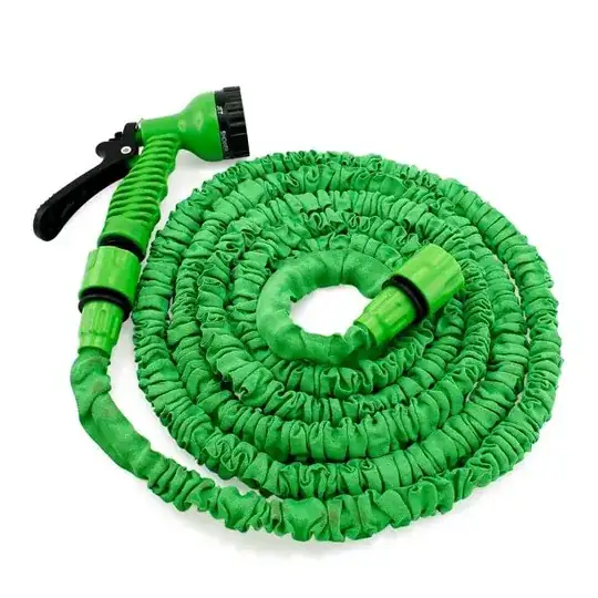

Second, easier suggestion: get a hose that doesn't need a reel and doesn't look bad. Various colors are available that could blend in to your lawn or flowerbed mulch. I have also seen "expandable garden hoses" used successfully for infrequent watering, and they shrink greatly when not in use, which keeps them out of the way. Buyer beware: there are many of very low quality, which are not durable or long-lasting. Example pictured (branding intentionally omitted).

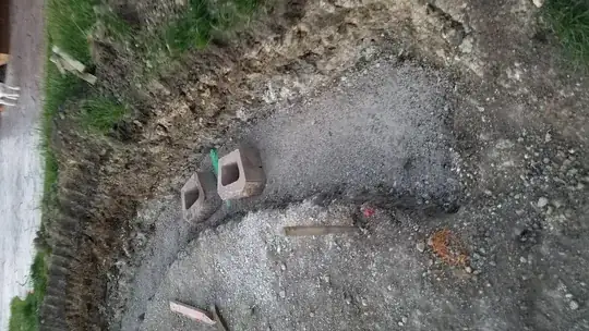

I had a similar setup to your except I put 2" conduit under the hose bib and ran a standard garden hose through the conduit to hose reel which then has a 50' garden hose on it. I mounted the hose reel on the fence in the middle of the yard.
