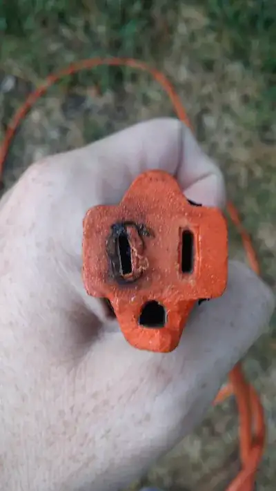

I had used several extension cords in sequence and noticed that one of the connections looked like this:
damaged extension cord end
Perhaps a year ago, I had replaced the other end of the extension cord in question, and suspect that the cord is faulty. When I ran my hand over the pictured female end of the extension cord, I received a slight shock. I don't believe the cord was wet, so I'm a little confused by how I made contact with a current-carrying wire, but that's beside the point.
Now, using new cords and different outlets, my lawnmower still won't operate. What kind of damage might my faulty extension cord have caused to my power tool? Is it repairable?

    Or the tool was failing and took the cord with it… – Jon Custer Jun 15 '22 at 01:54
    As requested by @Ruskes in a comment, it would help to know what power tool you were using, as that might indicate how much expected power draw there would be. In addition to the answer about not daisy-chaining extension cords, it's also important to note that many extension cords aren't actually capable of carrying a full 15A. Many use 16ga wiring, and are only capable of about 12A of current, max, at short distances. – Milwrdfan Jun 15 '22 at 02:58
  • Tool failed, took cord with it most likely. – Kyle B Jun 15 '22 at 16:30
  • it might be a fuse or one-time safety circuit in the mower that tripped. you might be able to fix it or replace the failed part. – dandavis Jun 15 '22 at 20:19

There are Warning signs everywhere not to use multiple power cords.
Your cord suffered current overflow leading to melting.
While the motor was running the Voltage dropped due to power cords.
Motor would have drawn more current to keep running.
Eventually the motor would burn up, from too much heat.

Evidance, molten plug on extension cord.
NEC specifies there should be no more than 5% Voltage drop from input to output. Your extension cord chain link had more than that.

That socket has given up the ghost. It's time to replace the socket.
They make field-installable replacement sockets for extension cords.
If that particular extension cord is causing an undue amount of trouble, I would look closely at its quality. Unfortunately a lot of "non-UL-listed" counterfeit/knockoff products are making it into the US market, mainly via mail-order.
If the tool was suffering low voltage due to a poor and melting connection, and you pushed the tool and ignored the groaning motor, it could have burned out the tool or burned up motor brushes.

  • Regarding is it reparable -- if your appliance has a fuse - then check that, otherwise this sounds like the first thing to break would be the motor windings -- i.e. not repariable ( at cost) – Hightower Jun 16 '22 at 02:52
