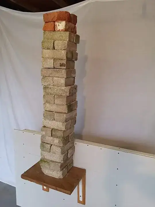

This sheetrock will have to be fixed-- good recommendations for that already on here. But for future attachment, consider a MUCH heavier duty wall anchor, if you can't attach it to studs. I really liked the GeeFix anchors-- great anchors. They are newer, more pricy.
An advantage of these is that towel racks typically require 2 screws to secure each mount. You can drive BOTH screws into a single GeeFix anchor, so it's a bit more secure that 2 separate wall anchors.
GeeFix wall anchors Image not mine, but they do hold a big load
