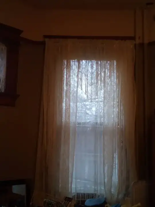

I have a similar concern about using the plastic during the summer. This past winter I decided to try the Duck Brand Tape "Cristal Clear Shrink Film" at the beginning of December. The kit was for a 10 window install with 2 rolls of the sticky tape and sold at Walmart for nine dollars & change.; How could I go wrong? So I did it. WOW!! I have to say this shrink film is amazing. I live in a 2 story townhouse type dwelling "I am first floor" and my neighbor upstairs has the exact floor plan, number of windows & doors, and the benefit of sunlight on the roof. We compared gas bills.. For January mine was $59.00, and hers was $130.00. Pretty amazing huh? So with that in mind, I am also thinking about keeping it up all summer. I have central air and am the type to start it June 1st, and not shut it off till Oct 1st. The only thing I did not cover was a single kitchen window to allow escape of cooking smoke if needed. But I don't get strong windows on that side of the house either. Spring in Philadelphia is SHORT to say the least. It goes from cold to having 2 nice days, than straight to hot. So what can it hurt. If it begins to peal from the heat of the July sun, I'll pull it down. I am only out $9.00, but if it has the same effect on my central air bill as it did on my gas heating bill, I am way ahead! By the way, the gas bill amount I spoke of earlier also includes the stove, hot water heater and the dryer. What I did not mention yet is that I am also a renter as you are. One thing you CAN & MUST DO, is invest a couple bucks in a programmable thermostat "placing the landlords safely aside somewhere, and install it ASAP. A good programmable thermostat can reduce cost by 30% just on their own. I did exactly that and have it set very low over night as recommended. Between the film and the lower temperatures at night, my gas bill was $71.00 LESS than the upstairs unit. But for you at this point, you might as well just wait till next November and try the Duck Brand shrink film, than leave it up till it (if it) peals off.
