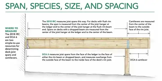

The 2018 IRC (as adopted by Oregon, where I live) allows a free-standing deck to have both cantilevered beams and joists. The 2015 IRC (as adopted by Texas, listed in your profile) is similar but has slightly different diagrams.
Beams are described in R507.5 Deck Beams: "Beams shall be permitted to cantilever at each end up to one-fourth of the allowable beam span"
beam cantilever diagram
Joists are described in R507.6 Deck Joists: "The maximum joist cantilever shall be limited to one-fourth of the joist span or the maximum cantilever length specified in Table R507.6, whichever is less"
Note that a joist cantilever in this configuration requires the joists to sit on the beam ("dropped beam").

I can't find any code for it, but my mind keeps saying you only get two feet of overhang on a floating deck... because the maximum spacing for posts supporting a 2x12 is 8', and one quarter of 8' is 2'.
"Maximum allowable overhang cannot exceed 1/4 of the actual main span."
And I guess w/e code this picture is citing, "the actual main span" is actually w/e the distance is to the next post because it's a freestanding deck.
https://www.pinterest.com/pin/520939881903050593/
Presumably when cantilevered into the building or attached to a ledger, you get to use the actual actual distance.
https://www.finehomebuilding.com/project-guides/decks/get-deck-joists-right
