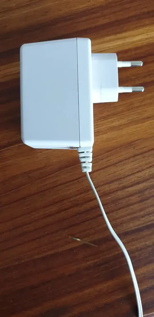

I want to re-wire an AC to DC power adapter for an ONT (Optical Network Terminal - AKA Fibre Box mounted on a wall) and replace the adapter with a standard DC plug. This is because I want to connect it to a UPS (uninterrupted Power Supply).
How do I tell which one of the two wires is the live or positive wire in this picture?

I am from South Africa, if that is at all applicable. This is the cable connected to an ONT.

    A photo of the plug blades may help. In US the smaller blade is hot – Kris Jun 30 '22 at 12:31
    What is a "standard DC plug"? Do you have DC wall service there? – isherwood Jun 30 '22 at 12:37
  • Do you have access to a DC volt meter? – JACK Jun 30 '22 at 12:48
  • @isherwood, no I am connecting this to a standard DC 10 V pin/plug that will plug inta a UPS (Uninterrupted Power Supply). – Romans Jun 30 '22 at 14:53
  • @JACK I don't unfortunately. But even if I had I don't quite see how that would work. The cable in the image is the current power supply cable to an ONT (optical Network Terminal - AKA a fibre box mounted on a wall) – Romans Jun 30 '22 at 14:54
    Best bet is to get a multimeter that reads DC voltage. Simple touching of output pin will tell which is positive/negative. Will need the same test on the UPS. Hoping the pins are hooked up the same is foolish. – crip659 Jun 30 '22 at 15:26
  • @crip659 How would the multimeter work? This is a power supply? – Romans Jun 30 '22 at 15:42
    Why not simply plug the white "wall wort" (in pic #2) directly into your UPS? That's how _all_ of my home electronics are protected by my UPSs, including my ONT, router, etc. – FreeMan Jun 30 '22 at 15:53
  • Use the red and black leads, one on the outside, one on the inside. If put on the way, the meter reads positive number, if backwards it reads negative. – crip659 Jun 30 '22 at 16:04
  • @Romans You'd have to cut the wire to install your new jack. A DC meter has + and - test leads, red and black. You plug in the supply and connect a lead to each wire. If you get a correct secondary reading, the wire to the red lead is your positive. If you get a negative reading, then the wire to your black lead is positive. – JACK Jun 30 '22 at 16:43

You don't have a voltmeter. Do you have a potato?
With the power adapter unplugged from your electrical outlet, cut the wires, strip a little insulation from the ends, twist the strands of each wire into a point. Do not allow the bare wires to touch each other from this point on.
Cut the potato in half. Take one half, and poke both wires into the cut face of the potato about 2 cm apart. Plug in the power adapter to the wall outlet. In a short time, the potato around one of the wires will turn green. That is the positive wire.
Unplug the adapter and clip off the ends of the wires so you have clean wire for soldering your new plug.
