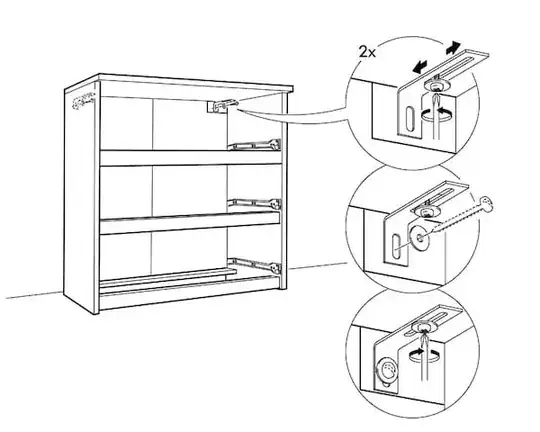

Attach the top to the wall with a metal bracket. That will also prevent it from falling over.
Most shelving units from Ikea come with instructions and the needed hardware for wall anchoring:
Ikea wall anchoring instructions
