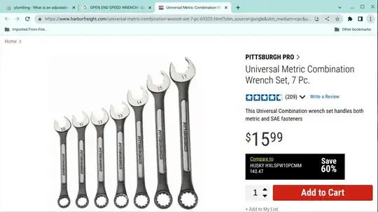

They are sometimes called open end speed wrenches. The splined open end gives ratchet-like speed for fast removal and installation. I am not affiliated with this company in any way.
JACK
  • 78,739
  • 72
  • 188
  • Thanks. That's not what they were using since they were using an adjustable one, but it does look useful. – ispiro Jul 06 '22 at 16:17
    "Handles both metric and SAE", but doesn't handle either all that well. Seriously? One wrench for both? I can see the little notch in the open end for the different size head, but I wouldn't put much faith in that, especially if the nut you were trying to remove was stuck. Looks more like those are "Universal Bolt Rounders". I've become quite a fan of HF tools of late, but I'll be avoiding these. – FreeMan Jul 06 '22 at 16:17
    @FreeMan `Seriously? One wrench for both?` - Since they're not _supposed_ to be precise (since that's what lets them move around), it might not be as bad as it seems. – ispiro Jul 06 '22 at 16:21
  • Maybe so, @ispiro, but spending most of my time working on crusty, rusty bolts under the hood, I'd shy away from anything that doesn't give me a _really_ good grip. I realize that's not what you asked, for, though, so maybe these will work well for you. – FreeMan Jul 06 '22 at 16:44
    @FreeMan Point taken. Thanks. – ispiro Jul 06 '22 at 16:50
  • A plumber would not be seen using that, but a car mechanics would – asinine Jul 06 '22 at 17:49
  • @FreeMan "Universal Bolt Rounders" is right, as soon as you go to really torque something down these things always slip. Other names would be "knuckle smashers" or "punch yourself in the face wrenches". – Z4-tier Jul 07 '22 at 23:46
  • @Z4-tier When you're going to really torque something, you use the closed end. – JACK Jul 08 '22 at 00:04
