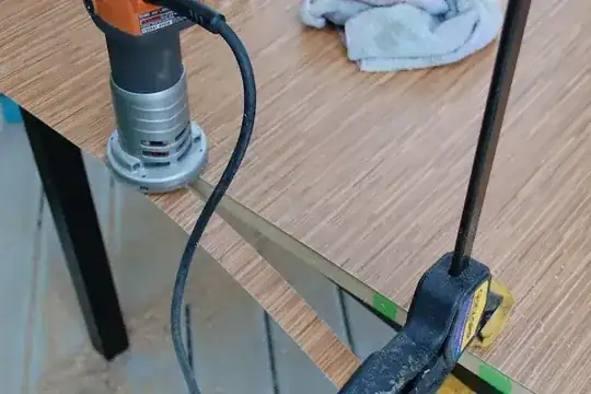

Particle board with laminate.
Cut laminate so it's a little larger, glue it on with contact cement and trim the edges with a router.
Cheap and durable.
Particle Board
Formica trimming
