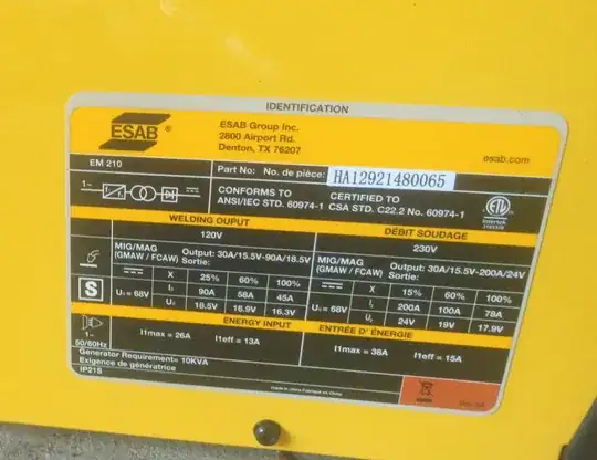

Edit thank you for the speedy responses folks. I will post pics of the nameplates tomorrow. Yes, welders are funky. I have a copy of the 2018 code and it only talks about transformer welders, motor-generator welders, and resistance welders.Both of mine are the inverter type. Maybe the 2021 code will mention them?

Here are the photos! The ESAB pulls 38A max and the cheap stick welder pulls 41.

    Welders are weird as blazes, and are sharply derated (favorable to you). Can you post photos of their nameplates? You can [edit] them into the question, don't post an answer. If you want to log in from a different device to do that, register your account first (tie it to an email/password, Google or Facebook). – Harper - Reinstate Monica Jul 08 '22 at 01:12

  • Yes, please post the nameplates of your welders! They're weird enough to have their own Code section written for them, even... – ThreePhaseEel Jul 08 '22 at 01:26
  • the ESAB pulls 15A effective at 230V . the other one looks like 31.6 – Jasen Jul 08 '22 at 12:41

For load calculation purposes, I would treat the welder receptacle as a 40A load. This covers both the current situation as neither of your welders has an I1eff (effective primary current) greater than 40A, and also permits the next occupant to use the receptacle for an EV charger instead. It also leaves you with 2 20A circuits of intermittent load, which is sufficient for LED lighting and a basic 120V tool circuit.
