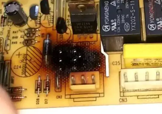

^ If it looks like that, it means someone was way overoptimistic about the heat that the component that used to be there could dissipate. So it overheated and barbecued the board.

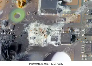

^ That's liquid damage. Water plus electricity equals electrolysis, so basically all lots of copper is going to be missing from that board. It's dead.
