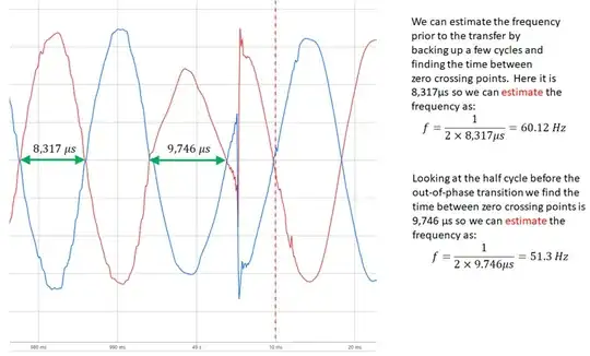

I have an SEL-735 PQ meter on my house and captured this couple days ago. We had a power outage and were running on the Generac. I happened to be outside when I heard the transfer switch "thunk" and my outside HVAC unit fan started making a sound like a stick had been stuck into the fan blade. I turned it off and upon restart it was fine. But, out-of-phase closing is a cumulative damage - it will take life off of motors etc.

UPDATE 7-12-2022: Based on @Jasen and @Gil input I now see that in is indeed a "break-before-make" switch action, but the out-of-phase transition is still present since the voltage on the induction motor load (compressor) cannot decay to zero immediately due to trapped flux in the rotor.
As soon as the Generac is disconnected (but prior to utility closing in) the frequency drops due to the induction motor slip. In this case the slip was around (60.12 - 51.3 = 8.82 Hz). You can see this (and I suspect that is what clued @Jasen to it) as the time between zero crossings gets stretched out. This is an immediate response to the induction motor being disconnected from the source.
The decaying voltage of the induction motor is a voltage source that is slowing down and reducing in magnitude quickly - but not fast enough to avoid the out-of-phase transition. Because this voltage is not in-phase with the utility the effect is that when the utility closes in these 2 voltages are additive (based on their phasors amplitude and relative phase position). So, the voltage across the motor may be higher than rated. A rule of thumb many designers historically used for a maximum momentary voltage applied to a motor is 125% of rated. This applies equally well to single-phase motors as three-phase.

Also, below is the phase-to-phase voltage that @Gils points out will be what the compressor experiences. Remember that the voltage across the motor is this voltage +/- some portion of the residual voltage still on the motor due to trapped flux.

  • Is the graph am measurement you made? I didn't think transfer switches were that fast. – Jasen Jul 12 '22 at 01:08
  • Yes @Jasen, it was each half (120V) of my service (a typical split-phase 120/240V service in U.S). I just labeled the A & B for convenience. The SEL-735 was sampling at 128 samples/cycle. My switch is clearly do a make-before-break. You see how the blue line was headed upwards and then BAM, got jacked back down the other way? That is way out of phase. If the transfer had waited another 4 ms it would have been 180 degrees out-of-phase. – relayman357 Jul 12 '22 at 02:59
  • That's crazy, synchronization would be easy. Just measure when the AC voltage between utility and gen L1 descends to zero, then SNAP! – Harper - Reinstate Monica Jul 12 '22 at 04:06
  • I can now you can see from the graph that the generator switch opened about 20 ms before the line switch closed. – Jasen Jul 12 '22 at 06:51
    Thanks @Gil, that is helpful (+1) - so I was wrong when i assumed a make-before-break had occurred. The end result is the same, the motors had voltage on them when the utility came back out-of-phase position with them. The induction motor has trapped flux in the rotor when you disconnect it from the source. This flux decays depending on mechanical loading, electrical loading, and is extended if capacitors are present. Due to slip it immediately is at a reduced frequency (this is evident in the shot now that I looked at it closer thanks to @Jasen). – relayman357 Jul 12 '22 at 15:17
