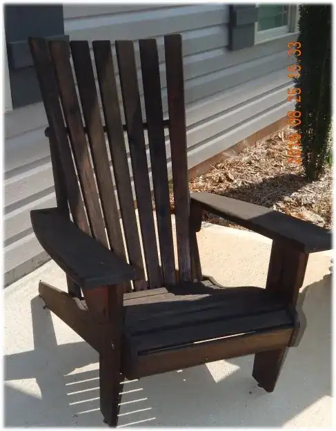

About 35 years ago, I build an Adirondack Chair using pressure treated wood. To preserve the wood I used an old farmers recipe using Linseed oil, which follows...
Apply oil, after time to soak in, wipe excess off... | Once a day for a week | Once a week for a month | Once a month for a year... | After that, as needed
My chair as I said, is about 35 years old and it has been outside since I finished the project. enter image description here
JRW
  • 51
  • I haven't seen linseed turn a wood this dark but you said it was pressure treated so the oil was just an additional protection layer. – Ed Beal Jun 30 '18 at 22:23
  • I've seen it once before. I had a butcher blocks that someone had coated in a dark varathane. I sanded it down to what appeared to be Hawaiian oak (which is almost white, and has an incredible glistening grain). I applied raw linseed oil, and the moment the oil touched it, it turned almost black. Most incredible color change I've ever seen, 15 years later the block is a very deep red colour. – Jefferey Cave Apr 10 '21 at 23:55
