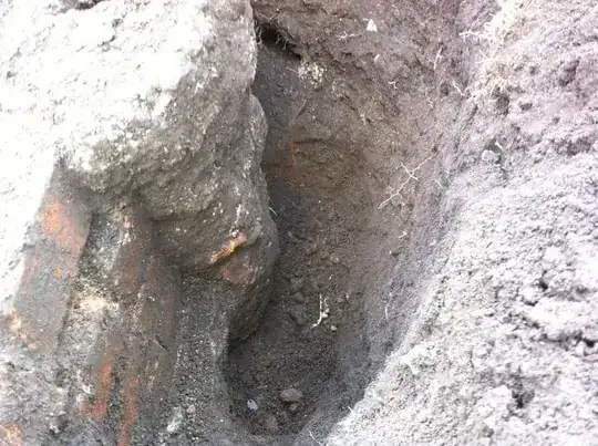

I need to replace a wooden fence post that was set into concrete. The post has snapped through rot at the base and the rot has set in so far that the post snapped about 2 inches beneath the surface.

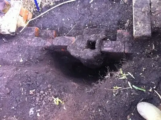

I had contemplated digging out the concrete to set in a new post (again with concrete) but have found the concrete is part set into submerged wall beneath the surface of the soil. The house is Victorian, I'm not quite sure what the purpose of the wall is.

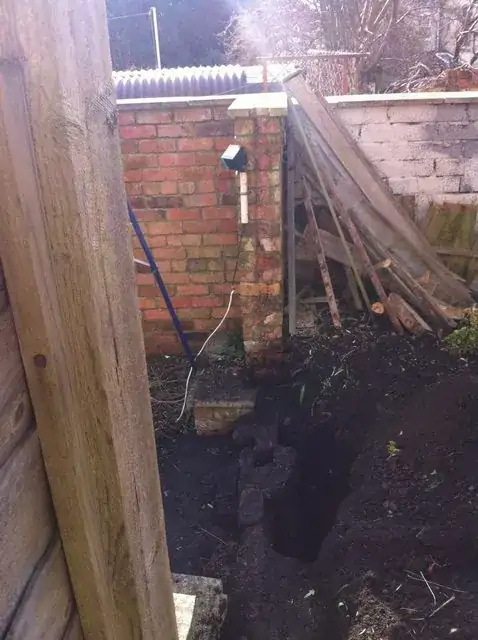

I think I have a number of options (I have also attached some pictures below)
  1. Dig out the concrete and re-do. It looks like it will be a difficult job but maybe the only solution.
  2. Use a repair kit (something like Metpost Repair). The problem with this is that I don't think there is enough post in concrete for the repair kit to attach to. Even the post that is left is very rotten and I don't think it would work very well.
  3. Place the post in another position. The problem with this being the wall running along the line of the fence beneath the surface is in the way of this.
Depth of concrete from old post Line the fence needs to take Concrete set into wall

I would break up the concrete and redo. It'll be a lot easier to take out of the hole in chunks, or re-use as backfill.

  • From the picture in the question, it might have been possible to do your suggestion more surgically in that case. Instead of breaking up all the concrete around the post stub, just break off one side. That would have made it "easy" to remove the post remnant and left a channel for the new post. Fresh concrete could then be used to replace the busted-out section and enclose the new post. – fixer1234 Oct 02 '17 at 20:45

It looks like there used to be a brick wall there and then at some point the above-ground portion was replaced with the wood fence. Breaking up the concrete is the best way to go, since you have already dug down to the bottom a breaker bar and sledge hammer would make short work of it. Another option is to put a 4x4 treated post right along the wall to one side of the existing concrete, then to match the previous line you would cut another 4x4 post and use lag bolts to attach it to the one that goes into the ground (the bottom of the 2nd 4x4 would actually be sitting on the top of the brick. This solution allows you to just bury the concrete and put the fence back up.
