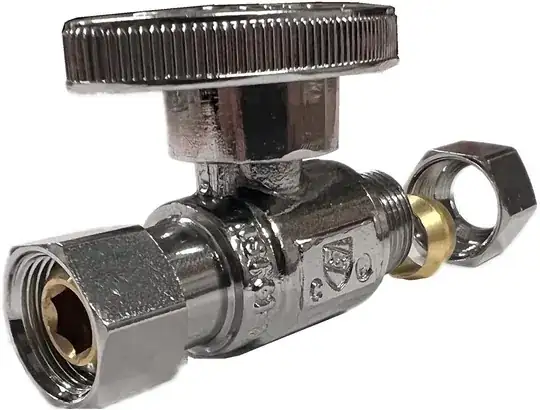

This is just to show what a "repair valve" or "piggyback valve" looks like:
Note that the female end has a loose captive nut and inside brass end designed to match the shape of a male compression connection. The captive nut gets tightened down to force the female end and male end together to make a solid metal-on-metal compression-quality seal without any ferrule or gasket or plumbers tape.
3/8-Inch O.D Female Compression x 3/8-Inch O.D Male Comp. A Lead-Free Brass Quarter Turn Water Shut Off Straight Repair Add On Stop Ball Valve,Chrome For Kitchen,Bathroom Faucet
