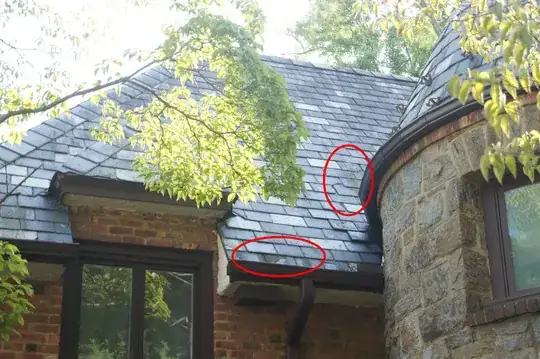

Are the spots inside the red circles moss?
Is zinc strip on slate roof a good idea to prevent moss? Thank you.

  • @jsotola If you click the image twice, it will change to the high resolution version. I intentionally keep the full photo to provide some context information, e.g. surrounding environment and possible moss around, and they might be helpful clue for someone willing to help. – bobby_yan Jul 28 '22 at 01:59
Photos 2 and 3 look more like lichen than moss. The first one might be moss. The easiest solution is to ignore it. It's harmless.
