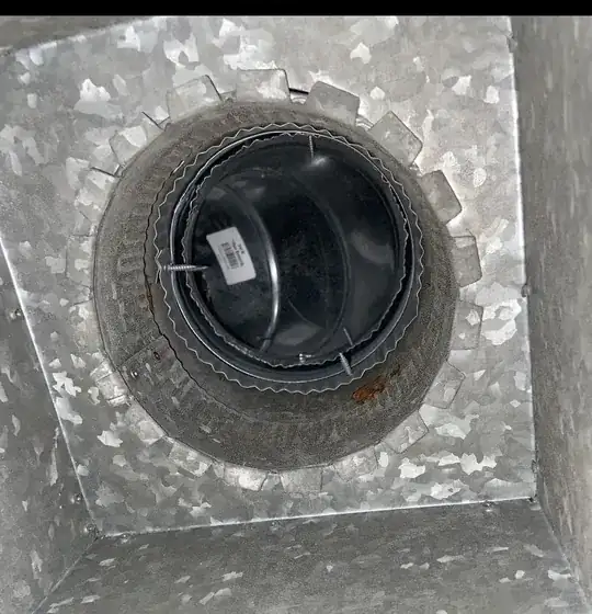

Should the internals of a register where connections are made have gray duct sealant?
looking in up at a ceiling register
  • where is the duct sealant in the picture? – jsotola Jul 25 '22 at 01:47
  • I’m sorry, I’m asking whether it should have it. There isn’t any in the photo. – Envieddesigns Jul 25 '22 at 02:12
  • are you asking about duct tape? – jsotola Jul 25 '22 at 03:30
  • Are you asking if code requires it? If so, then you'll have to tell us where you live and when it was built. Are you asking if it's a good idea to apply it? Then please clarify that. In either case, please [edit] the info into your question – FreeMan Jul 25 '22 at 12:12
  • Is there duct sealant on other connections in the system? – Steve Wellens Jul 25 '22 at 12:52
  • I sure hope that is a return and not a supply. Unless that is some odd square register opening. – Glen Yates Jul 25 '22 at 22:50
  • It is a supply register in a bedroom. It’s square shaped. If I have a duct leaking cold air in the attic where it connects to the trunk, I’d like to correct that, is there anywhere I can get specific instruction on doing so. I know there is a nylon zip tie on there do you just snip that off I’m also going to inspect that duct from the inside if I can disconnect it from the trunk. There’s a crap load of foil tape there an still feel air. Not happy with that. – Envieddesigns Jul 26 '22 at 13:01
  • @Envieddesigns It sounds like the installers did a $hit job with the flex duct in your attic. Google "connect flex duct to collar" to get started. – MonkeyZeus Jul 26 '22 at 13:58
Not typically, no.
Duct sealant, or mastic, is applied to the exterior of the joints. You don't want it on the inside because its texture would have a tendency to trap dust and introduces turbulence which reduces airflow.
If you must apply mastic to the inside due to accessibility issues then read the label and make sure it's non-toxic. It will smell for a few days until it fully cures.

  • My power company recommended that I take a bucket of mastic and a cheap work glove and smear it around the inside of the duct/register junction. I guess there are different recommendations from different folks. – RetiredATC Jul 25 '22 at 17:06
  • @RetiredATC Why did they say this? Please see my updated answer. – MonkeyZeus Jul 25 '22 at 17:49
