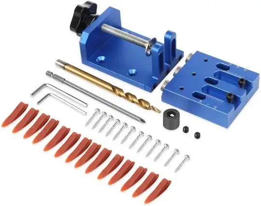

If you have good wood behind that drywall and don't want a visible bracket, I'd say that's a good use for a pocket screw.
Picture is of a random pocket-hole kit from the Internet, but they all use the same principles. The hole is drilled at a 15-degree angle to the joint with a dual-diameter drill bit, then a screw is inserted into the large hole, passing through the smaller hole into the wood. Fill what's left with either dowel finished to match or wood putty.
