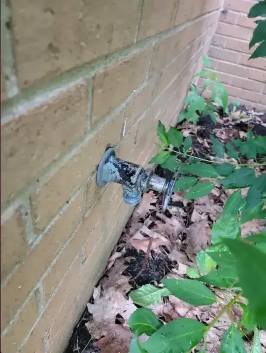

We moved to a house with "older"/original spigots which we want to replace since they are leaky, old and not very useable (probably not up to code either) - assumption is that they are connected to galvanized steel pipes. We can't tell since basement is finished. The leak is where the water comes out from the spigot (where it "should be").
We got an insanely high quote from a plumbing company to go through the basement ceiling and replace the old pipes and then the spigots.
I was wondering if there is anything I could do myself which would be "easier" in order to at least stop the leak, not even replace the spigot itself since we don't "have to".
This is how the spigot looks like: https://i.stack.imgur.com/pOew7.jpg

    You mean the water is just coming out of the actual 'hole water comes out of'? Why not just change the washers? $£€ 0.10 each. – Tetsujin Aug 02 '22 at 16:44
  • Yes it does come out of the "hole water comes out of". How would you go about changing the washers? – Idos Aug 02 '22 at 16:45
  • At a guess - water off at the main. Unscrew the nut on the central shaft, pull the entire centre out, take it to a plumbers' merchant & say in your best 'I don't know what I'm doing' voice… "I need a new washer for this." [The thing about washers is they really all do look the same. Only today I did just the same thing - it took them half an hour going through boxes of the buggers before they found the right one. ] – Tetsujin Aug 02 '22 at 16:47
  • What @Tetsujin said and support the valve base while unscrewing the nut counterclockwise so the whole valve doesn't turn. – JACK Aug 02 '22 at 16:51
  • Most of that insanely high quote was probably due to labour of removing and replacing ceiling plus the pipes. Most people can do pipe replacement themselves with a little easy to get knowledge. Ceiling work is also easy. – crip659 Aug 02 '22 at 16:51
  • @JACK - absolutely - I'm actually surprised it's not screwed into the wall, just perched on top, held by its own pipe. – Tetsujin Aug 02 '22 at 17:24
  • While getting new sealing washers, pick up an add-on vacuum-breaker (anti-siphon device) which screws onto the outlet, as that is the only way these appear to be "not up to code" and that will bring them "up to code." ...And provide new places to leak in the future, but thems the breaks. Apply a bit of brass polish and those might look quite spiffy! – Ecnerwal Aug 02 '22 at 17:31
It's likely that you only need to replace the packing that shuts off the water.
You can access that by first turning off the water leading to the spigot and then turning the nut that it just behind the handle. That should make the entire mechanism come out. It looks like a frost-proof spigot so the packing will be deep inside.

  • To reiterate Jack's comment here - use a wrench to hold the faucet still while unscrewing the valve packing nut. Might as well pick up some valve stem packing material while getting the new sealing washer, too, in case it's needed. – Ecnerwal Aug 02 '22 at 17:33
