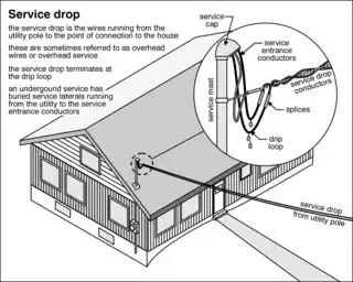

Here is a photo of an overhead service termination.
Click for larger view
Philip Ngai
  • 3,423
    The mast would be considered the "*point of attachment*", not the "*termination point*". Typically a meter socket, or a junction box on the outside of the structure would be the "*termination point*". They may be satisfied if you install the mast and leave the feeder wires hanging loose, since they'll then have a place to connect the service. Though this would only be used in an overhead service drop, so may not be applicable in some situations. Communicating with the service provider to determine exactly what they want, is often the best course of action. – Tester101 Feb 21 '13 at 12:57
  • The splices in the picture are the termination points, not the mast. Around here, your electrician runs feeder wires from the meter box to dangle from the mast as shown in the picture and the utility makes the splices just as shown. Of course one should check with their local utility to determine their requirements, this was presented as an example. – Philip Ngai Feb 21 '13 at 19:28
  • I was just pointing out that not everybody is connected through an overhead service drop, and that asking the service provider is the best way to insure you've provided what they need. – Tester101 Feb 21 '13 at 19:36
