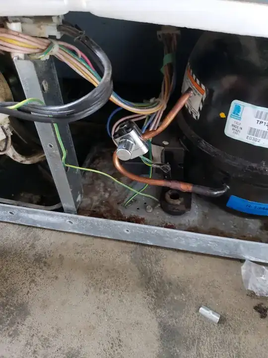

Edit: Looking at this answer: https://diy.stackexchange.com/a/141659/77713 I am inclined to think this is related to the compressor system / refrigerant. My coils look exactly like those shown in the last pic - iced at the input but no frost whatsoever below. So how do I diagnose this further? Or if that system is something I can't repair myself then is it even worth continuing to diagnose?
Edit: Based on other reading I'm just going to roll up my sleeves and install a valve on the compressor suction line and test the pressure there. A bullet piercing valve is easy to install and given that this fridge is probably 25 years old I'm not worried about voiding any sort of warranty. Although I haven't completely confirmed that the defrost heater works, I feel certain that the evaporator coils are not cooling properly (regardless of whether the heater works). So I'll need to address that issue first. Will update again soon.

  • @Gil I don't consider myself a pro but I've worked with pumps and plumbing before, and after watching 5 people install bullet piercing valves on compressors I think it's worth a shot. Worst case scenario it fails and leaks any remaining refrigerant and I'm still in the same spot (will have to install a permanent fill valve and completely refill the system). Best case scenario I just need to add r134a to get it back running and can check for leaks later with UV dye. The valve, gauge, and r134a are <$50 combined so that's still way under my "toss it" limit. – The Shoe Shiner Aug 11 '22 at 17:33
  • We use to use a valve called Tap-A-Line. It would clamp around the tubing and when you closed it it punctured the tubing. They worked great and lasted a few years. I use to get them from My refrigeration supplier or Granger. You need a handle assembly to use it. If it has pressure you are good to go, if it has a vacuum you may have to evacuate it first. – Gil Aug 11 '22 at 18:54
  • @Gil refrigerant was definitely the issue. I used a bullet piercing valve and added refrigerant till it was at 2 psi and now everything is working again. I'll be adding more details of the fix as soon as I'm able. – The Shoe Shiner Aug 13 '22 at 14:01

So ultimately the problem was refrigerant, specifically, the compressor did not have enough of it. Because this is a closed system, that implies there is a leak somewhere, but finding and repairing the leak is a different issue (that I may or may not take up). However the short/mid term fix is to fill the compressor. This fridge uses r134a refrigerant, a common type, which can be obtained from most auto parts stores. After watching multiple DIY videos on how to fill a closed system compressor I was able to do it and get the fridge back working. I would strongly recommend watching a video or two on how to fill a fridge compressor (there are many) just so you know what all you're looking at, but it's not as hard as it sounds. A couple pictures of my setup are at the bottom.

  1. Attach BPV Attach the bullet piercing valve to the fill stem (or if it doesnt have one, then on low pressure suction line) of the compressor. These valves come with instructions and you'll need to pick the right size for your compressor line. Essentially it pierces a hole into the copper pipe while also creating a (supposedly) air tight seal around it so that you can safely fill the closed system.

Compressor with BP valve attached
