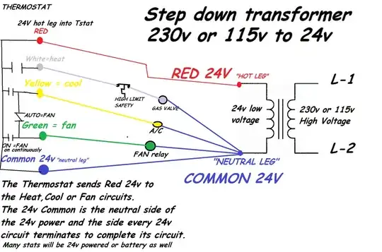

You guys down voted the only answer that is correct and up voted one that is completely wrong!!! You CANNOT use just one wire from a transformer and expect to get it to do a thing for you. The simple answer to your question is that if you add a transformer you want to tie the lines from it to Rh and C. Most modern thermostats I know of expect to pull power between Rh and C. You do NOT want to tie Rh and Rc together since your heating and cooling are on separate transformers and you don't know if they are truly floating.

I have no 'C' wire and I just installed a Honeywell RTH9500. My furnace is a six zone hot water with radiant floors. Each thermostat on has a red and white wire. I purchased a 24VAC transformer and was able to put it into a closet that is behind the location of my new thermostat. I connected the R and W wires as you would expect and ran another set of wires to the transformer and connected each wire to each 'AC' terminal. I did not use the Ground terminal. Lastly I connected on of these wires to the 'C' and one to the 'Rc'. I then pulled the jumper for 'R' and 'Rc', turned the power back on and everything works as expected. Hope this helps... it was easier than I expected. Love the Wi-Fi connection!! (5 more to go)

You will wire the cooling transformer to RC and the heat transformer to RH
I am replacing my old thermostat with a Lyric T5 Wi-Fi thermostat. I added an additional Transformer after speaking to Honeywell support, as my control board has no C terminal. I first only ran one side of the transformer to the T5 and connected it to the C terminal(as suggested in an answer above). Nothing happened the thermostat would not power up. I had to run the other side of the transformer up as well connecting it to the Rc terminal. I also moved the switch in the terminal block to the down position. Unit powered up and works perfectly.

I ran transformer wires up to the location of the thermostat. Attached the Red Wire to the R Lug & the White Wire to the W Lug on the New plate than Attached one of the transformer wires to the C Lug & the other to the RC Lug. I did not remove any jumper wires.

Here's my take. Typical combination forced air furnace / AC configuration will source power when T-stat "calls for heat or cooling". When you hear the T-stat click, a relay is closing and the Stat is closing a circuit back to furnace. When the temperature meets Stat setpoint (stat is satisfied) the circuit opens and you hear another click. The stat is no longer sourcing power.
WIFI stats need to have power "all the time" to enable the connection to your home WIFI router. The "C" terminal is COMMON or Neutral back to the power supply on the furnace. The stat is now "stealing" power from the 24V source at your furnace. In a lot of cases, the transformer is used by the complete heating and cooling system - common to both. In some cases, when the furnace is "off" and you're in cooling mode, you may have a separate cooling system with its own dedicated power supply. This would be when you'd see indvidual RC and RH wires. Sourcing cooling at RC / heat at RH.
Goal is to have the C to a common or "always energized" power supply at your furnance/boiler, space pac, so on, so forth. This is why it is not simple or typical. There are many ways to apply HVAC to homes and many manufacturers have their unique methods.

So we moved to trial and error based on various videos on U-Tube. The HVAC call out fee is 250 USD so it is more than a new thermostat and it is only 24 V. So here is what I found. The "C" lead from the added 24 volt transformer goes to the "C" on the thermostat base. I then to the "Lead" or "R" from the added 24 volt transformer to the "R" block. I hooked the "R" from the furnace and hooked it to the "Rc" on the thermostat base. Nothing on the thermostat. (Hooked up the other way around gave me heat but no AC). So I said my prayers and found the jumper. I jumped "R" and "Rc" on the thermostat base and EVERYTHING WORKS. I have AC, manual over ride on the fan and heat. Good luck on getting your system up and running.
