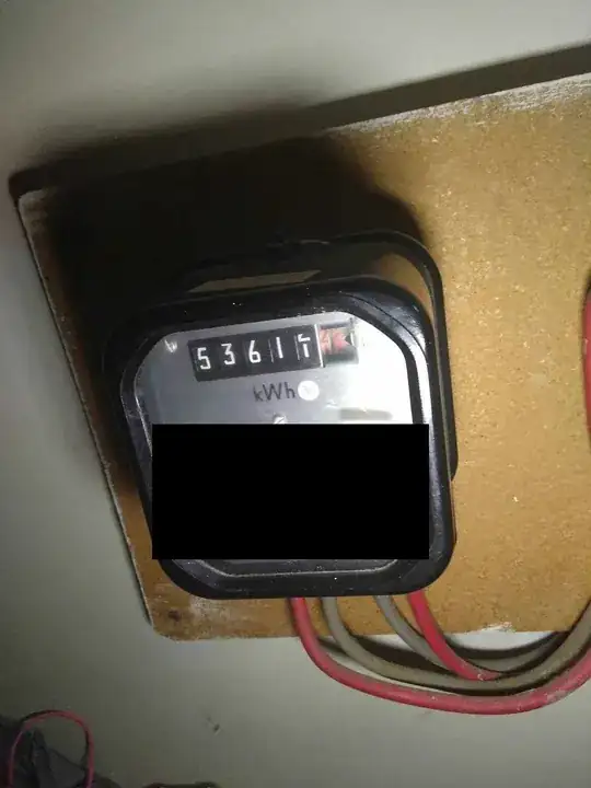

My house (I live in the UK) failed an electrical safety inspection because of a missing main supply cover. I have tried using google to find one to buy but can't find anything at all. Does anyone know how I can go about getting the right kind of cover for this? electric main
For context, the unit is connected to the electricity meter electric meter
UPDATE: I reported this to UK Power Networks after the advice I got here and they booked somebody to come out 2 days from when I called. The guy had a spare cover in his van - he collects the parts when he attends demolitions. So it was easy in the end.

  • "Main supply" for what? That can't possibly be where the power from the pole comes into the house - the wires are _far_ too small for that. What product is this attached to? – FreeMan Aug 16 '22 at 17:23
    The red and grey cables go into the electricity meter. I don't know where the white one at the bottom goes. – lapsel Aug 16 '22 at 17:28
  • Thanks, I've added more info and will try to find a local shop that might be able to help. – lapsel Aug 16 '22 at 17:35
  • LOL, I don't think there was anything really identifiable in that pic. Maybe that's a unique meter number on there - blacking that out would have been reasonable. :) – FreeMan Aug 16 '22 at 17:48
    I just thought better safe than sorry as I know nothing about it! :) – lapsel Aug 16 '22 at 18:01
    @FreeMan: It almost certainly is where the power from the "pole" (more likely underground cables) comes in - probably 60+ years old by the look of it... – psmears Aug 17 '22 at 10:48
    @FreeMan If you take a close look at the end of the red conductor, it looks like at least 16 mm² copper (~4.5 mm in diameter, something like #6 AWG), which is enough to carry 60 A (the rating of the main fuse, the white box under the terminals). In a 230V country this is more than enough for a small to mid-sized house. – TooTea Aug 17 '22 at 11:53
  • I surrender! From the picture that wire looks much smaller than I'm used to seeing as the main feeder cable in US installations. Please forgive my lack of experience. I've learned something about the rest of the world from these posts. – FreeMan Aug 17 '22 at 11:55
  • @FreeMan Aluminium is almost unheard of in Europe, compared to US. In addition, we have double the voltage. I have a 80m^2 flat; my incomer is 6mm^2 Cu. – vidarlo Aug 18 '22 at 18:56
  • @psmears About right - the meter date is 1969. – user1908704 Aug 19 '22 at 15:10
  • @user1908704: Haha - how did you find that out? I was just guessing... – psmears Aug 19 '22 at 15:15
  • @psmears First two digits of the meter number (in the original pic) are the year – user1908704 Aug 20 '22 at 21:13
