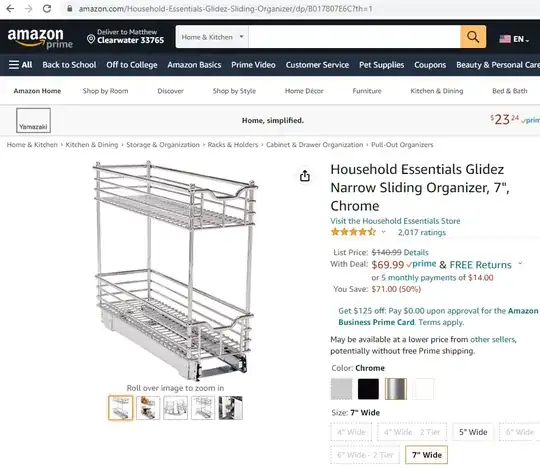

Building on Ecnerwal's answer. Put something like this in the dead space so it slides to the left. Put the stuff you access frequently in a basket in front of the pipes. Take the basket out and slide organizer to the left.
