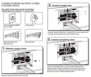

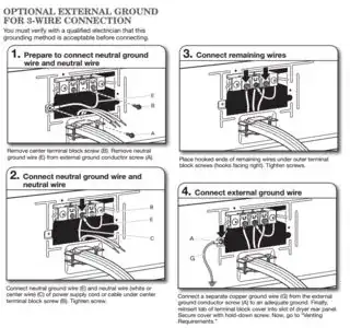

If you check the manufacturers installation instructions, there should be a procedure for connecting the dryer to a 3 prong receptacle. The procedure can very from manufacturer to manufacturer, so make sure you check the documentation for your specific dryer.
From a random whirlpool manual:
This dryer is manufactured ready to install with a 3-wire electrical supply connection. The neutral ground conductor is permanently connected to the neutral conductor (white wire) within the dryer. If the dryer is installed with a 4-wire electrical supply connection, the neutral ground conductor must be removed from the external ground connector (green screw), and secured under the neutral terminal (center or white wire) of the terminal block. When the neutral ground conductor is secured under the neutral terminal (center or white wire) of the terminal block, the dryer cabinet is isolated from the neutral conductor.
Click for larger view

I have Moved a dryer with a four conductor cord into my home that has a 3 prong outlet. The outlet provides 240V and 120V. The house wiring for the circuit provides the two hots, the neutral, and a ground wire. the ground wire is bonded to the outlet box. I replaced the cord with a 3 prong plug and attached an external ground wire to the connection of the fourth cord wire (ground) and bonded the other end of the external ground wire to the ground wire in the outlet box. I left the internal bond wire where it was for the four wire cord. This installation IS directly equivalent to the four prong installation.
As you can see, these two circuits are the same.
  • This installation is definitely NOT "directly equivalent to the four prong installation". Also, you DO NOT "connect an external ground wire"! The neutral in the 3-wire cord also serves as the ground since you must leave the bond in p0lace inside the dryer. – Speedy Petey Jun 02 '14 at 10:38
    NO SIR. Neutral and ground are not same thing. They may be connected at the main breaker box, but they serve two different purposes. Neutral is the designated return path for the hot wires, while ground is fail safe return path for stray current in the event that a hot makes contact with the frame of metal appliance. The four wire installation has a ground wire integral to the cord, while the 3 wire with external ground supplies the exact same thing. The picture provided in the post above shows how to do this. (H+H+N+G) = (H+H+N)+(G) simple math! Always bond appliances to a good ground. – Posted by another Tim Jun 08 '14 at 03:09
    Tim, please do NOT explain this to me. I am WELL aware of how it works and you are wrong. A 3-wire dryer cord DOES NOT use or require an "external ground". This may have been acceptable for a while many years ago but it is NOT acceptable now. A 3-wire dryer cord has the neutral bonded to the dryer case internally. The neutral DOES/DID serve both purposes. This exception was removed from the code several cycles ago which is why 4-wire dryer cords, with a dedicated equipment ground, are now required. – Speedy Petey Jun 08 '14 at 12:26
  • See post above for proof. – Speedy Petey Jun 08 '14 at 12:38
  • @SpeedyPetey I have read the above and totally agree. What I have done is the equivalent of a four wire system. I have used a three wire cord for the current carrying and have an external ground wire. It is wired exactly like it has a four wire cord attached. the ground wire is bonded to the ground wire present in the outlet box and connects to ground wire on the frame as per instruction manual. I am not using the neutral as the ground. How is it any different? – Posted by another Tim Jun 08 '14 at 21:24
  • @SpeedyPetey I think we are on the same page, we just dont know it. I edited my original post for clarity. I am trying to show that I am using the four wire system. I believe that it is a safer system. I am just doing it with a ground wire that is not integrated into the cord. Sorry for the confusion. – Posted by another Tim Jun 08 '14 at 21:55
  • Sorry, but this is NOT safer, NOR is it the same thing. Whatever though, you are free to do as you wish. Just please do not suggest to others that this is an appropriate or safe alternative. – Speedy Petey Jun 08 '14 at 22:47
  • There. As you can see, this installation conforms to all the NEC stuff you have shown. This is a safe installation and is equivalent to using a four wire cord. – Posted by another Tim Jun 08 '14 at 23:55
  • You keep telling yourself that Tim. It is NOT complaint and NOT the same thing. You keep posting and editing just so you can convince everyone you are right. You are NOT. – Speedy Petey Jun 09 '14 at 09:33
  • The drawing was my final edit. The electronic circuit is exactly the same. Electrons cannot tell the difference. If someone, including you, can explain to me why this is not electrically the same as using a cord with 4 wires, then I will retract it. If your reason is that the ground conductor is separate from the cord, say so! That is the only difference. Stop with the "You're wrong" stuff and give an actual reason. – Posted by another Tim Jun 10 '14 at 00:14
  • Tim you are incorrect, it is not NEC-compliant to have a bare THHN wire coming out of the outlet like in your left-drawing. It is of course electrically-equivalent, but it looks extremely unprofessional _(which is a large part of the NEC - it's not **only** about safety)_. If you already have a dedicated ground coming to the outlet _(which is the hard part)_, you should just replace the dryer-cable and outlet with a 4-pronged connection _(the easy part)_. – BlueRaja - Danny Pflughoeft Sep 03 '15 at 16:46
  • I would say Tim's separate grounding strap (with bootleg strap removed from the dryer) is certainly better than no ground at all or a "legal" bootleg ground which is what a 3-prong plug is. But it is not code. The Code way is to use a 4-wire cable and fit a 14-30 receptacle which uses that existing ground, then gather some hobbits and elves and toss the 10-30 receptacle into the fires of Mount Doom from whence it came. – Harper - Reinstate Monica Jun 17 '17 at 23:24
