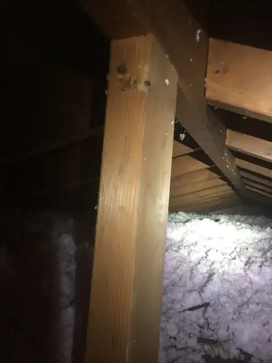

enter image description hereI am trying to install a new light fixture, but there are 9 wires--I wasn't able to see how it was connected and I'm pretty sure it was wrong to begin with because bulbs kept burning out right away. Initially the whites were together, 3 of the black wires were together (including the hot wire), and one single black wire. There are 3 pairs, and one bunch with 2 blacks and one white. The casing is literally crumbling at the touch.
How can I properly wire this to a new fixture?

From the looks of those pictures you won't be able to properly wire this without some major rewiring. Those wires have insulation that is cracking/ crumbling all the way up up the connectors that hold them in the box. You would need to identify all the wires and would need to turn on the power to do that. That box is a fire waiting to happen and you do not want to be up on a ladder when it starts arcing. Those wires need to be replaced, up into the ceiling and maybe even further. If you have an attic and can get to that box, the job might be easier. If no attic, you're looking at making holes in the ceiling. I love DIYers but this is one of the very few times I'm going to say you need some professional help.

Professional Electrician here, I hate to say it, but those are fabric coated wires, they stopped being installed in new homes back in the 60's and very early 70's. Any surviving cloth wiring is way past its service life now. I know its going to be expensive, but if you dont want to risk burning down your house, this wire needs to be entirely replaced ASAP. Yes a total home rewire is going to be between a 2 and 10 thousand dollar job, but it needs to be done. and this is no DIY task, you need to call in the professional's for this one.

You have to find out with certainty what each of those wires are. One may be the supply of power, one may go on to other outlets, one or more may feed switched power to other lights in the same room, one or two may be switch loops for a light and fan. Some of them may be disconnected at the other end, some may even terminate in walls. Hopefully in junction boxes with wire nuts but in many cases you'll find disused wires terminated poorly with just tape. With that many wires, hopefully you can figure out where each one goes but if not, you have good reason here to worry about poorly terminated wires inside the walls.
Some of those are badly damaged, as noted in another answer. Sometimes they can be repaired but you have so many wires in such a small box it will be impossible to repair the brittle old ones properly.
I'm afraid I agree with other answers here: you should crack open at least a bit of the ceiling, and probably more than a bit, to replace damaged wires, discover and remove disused ones and understand what they all do.
One very important clue is that all the white wires were tied together. This suggests one circuit coming into the box, and from there it feeds a switch and some plugs in the room. In older houses the wires typically run across the ceiling in the attic and straight down the walls to the plugs and switches to minimize the number of holes that had to be drilled by hand. Hopefully the attic is above this box and you can get to it.
First, with everything apart like you have, check to see if there is one hot wire. This will be the hot wire from the breaker. All the white wires are the neutrals. Mark the hot wire (piece of colored electrical tape).
Second, the single wire probably goes to the switch, along with one of the hot wires. Check for continuity (with the power off) and get in the attic and trace it out. The single wire would be connected to the lamp.
The other two hot wires (and corresponding neutrals) probably go to plugs in the room, or plugs in adjoining rooms. Are there any plugs that are not working with everything apart? Again, get in the attic and try to trace the wires out. There may be multiple plugs tied together down low. There should be at least two that are not working.
Finally, now that you have everything traced, you should replace all the wires. If you are lucky, all the wires will run along the attic and go straight down into the plugs and switches. If so, the job won't be too bad.
