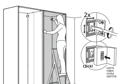

in steps 7 and 8 you should have screwed in feet into the front end of the base, step 22 shows how to use them to level the wardrobe.
Those can be screwed in and out to level the wardrobe. You can access them from the inside with a phillips head screwdriver.
image showing how to level the wardrobe using a level and phillips head screwdriver
However don't slide the wardrobe around while those feet are resting on the ground, otherwise they will get twisted around and do some damage. So make sure to attach the top shim to the wall before you do the final leveling.
Though if the floor slopes towards the wall those feet won't help. If that is the case you can use shims and wedges under the backside of the side panels, like the kind used to plum a door or window in a frame.
