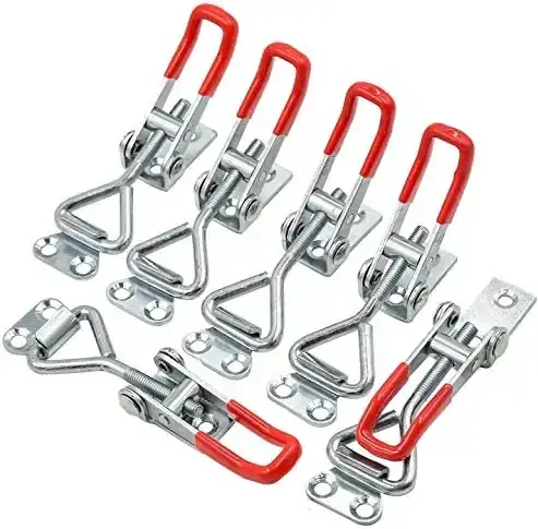

You might consider something like these cam latches for the outside attachment point. These things are the epitome of quick-release. Cam latches
Cam lock furniture fittings - Ikea style flat pack furniture uses them a lot.
Cam
