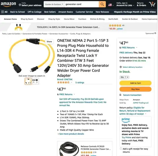

OK, I know this isn't a DIY question, but had to ask it and to point out the horrible things that get sold. Who in their right mind would use this? It completely bypasses all safety mechanisms. Could backfeed into the power grid, endangering lineman. Could severely shock or electrocute the user. It's so short that it could encourage generator usage in an enclosed space, like an attached garage.
Again, I know this isn't a DYI question and that probably everybody here at SE knows this is a horrible product, I only bring it up so that if you know of anybody that has this piece of dangerous junk, make sure they get rid of it asap. I couldn't believe it when I saw this.

pic of terrible extension cord

    searched amazon, it's gone, but avail on ebay and walmart. they should be sued for carrying this. – George Anderson Sep 16 '22 at 20:11

    does it comes with instructions ? – asinine Sep 16 '22 at 20:50
    @dandavis As a libertarian, I mostly agree with you in principle. But it takes a lot of work to vet products whether they are safe or not. Would you still support asbestos usage? How about restaurant inspections? Would you like to have to research a restaurant for ratings about it's food handling practices before you ate there? And who knows if those ratings were real or posted by bots? I agree with limited and accountable gov't, but there are some appropriate roles protecting public safety. Hate to say it but frankly, protecting idiots from themselves. – George Anderson Sep 17 '22 at 01:41
    These monstrosities are generally used as the Absolutely Wrong Way to connect a backup generator to a circuit, creating the risk of electrocuting one of the linemen trying to repair your power lines. So they do have a reason for existing and being purchased; it's just a bad one. – keshlam Sep 17 '22 at 05:53

  • if you were going to use this, and you shouldn't, but would shutting off the breaker and plugging it into a GFCI then the generator remedy some of the issues? Curious if a GFCI works "backwards"... – dandavis Sep 17 '22 at 09:20
  • @dandavis Yes, but if you turned off the breaker on the circuit this despicable contraption was plugged into, it would only power the outlets/lights on that circuit. You'd have to turn off the main breaker to power more of the house and not risk backfeeding into the grid endangering lineman repairing an outage. But worse, it's not fool proof, anyone using this would need to know what breakers to turn on and off to be safe. And backfeeding like this **CLEARLY CERTAINLY NOT NEC COMPLIANT** – George Anderson Sep 17 '22 at 12:59
  • @EricDuminil CO poisoning ...see my original post. It's so short it would encourage people to use a generator in an enclosed space, like a garage, leading to CO buildup and possible leakage into the home. Unlike CO2, CO is a POISON! – George Anderson Sep 17 '22 at 13:04

  • HOLY CRAP! This is even worse. Given it's a 240 volt supply (4 wire), let's see what the typical uninformed user would do: Probably plug both ends into the same outlet, which would result in a total short. Forgive me for this old quote, but it applies here: . Ist easy schnappen der springenwerk, blowenfusen und poppencorken mit spitzensparken. Ist nicht fuer gewerken bei das dumpkopfen. The user would have to identify 2 separate circuits on opposite legs, not an uninformed user would naturally do. What an even worse product than the one I called out. – George Anderson Sep 17 '22 at 15:33

How it can be sold: Amazon (and other vendors) sliding around laws pertaining to safety of imports by directly connecting buyers who become the importers to sellers with no ethics whatever. Helps if they buy themselves some politicians to make the laws that way (and they did.)
Note that this makes the person who bought the hazardous item the importer, and responsible if it causes anyone else harm or damages. The item is unlisted, thus, it violates code (and your insurance terms, normally.)
Do. Not. Buy. Electrical. Stuff. From. Amazon, Aliexpress, or any other platform that "blends" stuff they may actually sell with directly imported unlisted, unsafe crap. Aliexpress is all direct import, while others confuse things more.
Of course, in this specific case, the old fashioned way is also common among fools - buy two listed plugs and some listed cord and assemble it yourself. There's a reason it's known as a suicide cord.
