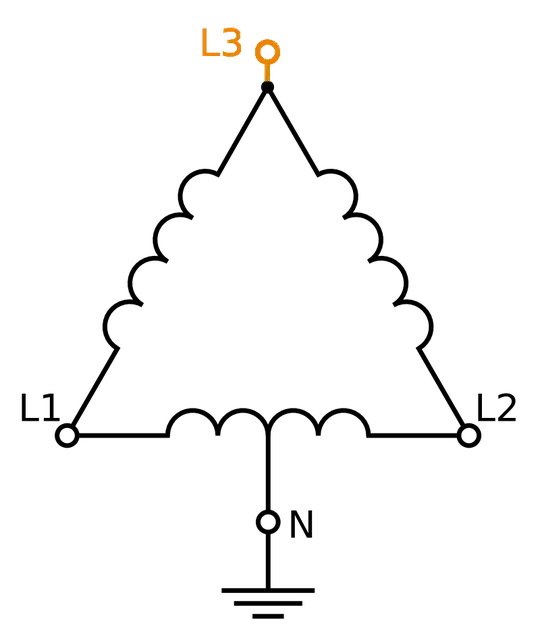

This is what they are talking about when marking with orange:
The second leg in that example is your high leg.
