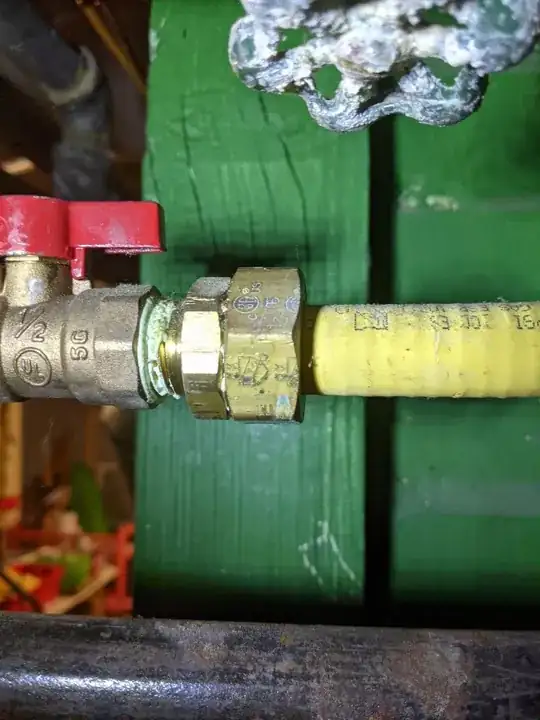

Can anyone tell me who is the manufacturer of this CSST (and related fixture)?
CSST enter image description here
codechimp
  • 705
    You might try wiping the dust off off and taking new pictures **specifically going for a complete set of the text,** given your question. – Ecnerwal Sep 26 '22 at 19:52
  • Any reason for wanting to know? Imagine any make of 1/2 inch(any size) pipe has the same specs. – crip659 Sep 26 '22 at 20:24
    @crip659 Wrong! The CSST fittings are not necessarily interchangeable across brands. CSST fittings and tubing must, generally, be matching set by manufacturer. The main difference being the pitch of the corrugation. – codechimp Sep 26 '22 at 21:08
  • @codechimp Thank you for that information. – crip659 Sep 26 '22 at 21:12
If the conversation at InterNACHI is correct, then your CSST is Titeflex brand.

It's a Titeflex product. That funny "Tg" looking trademark is an earlier Titeflex logo. They make Gastite.
